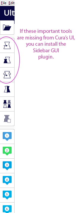

I chose Cura for this instructable because it's open source, in active development and very popular. It's also the only slicer I've tried. Though that says a lot, I dislike the user interface and Cura definitely has some downfalls (especially noticeable in this project) that I hope will be corrected in the future. Firstly, Cura's "prime tower" starts working at layer two. This issue has been handled in the builds by smartavionics. Another inconvenience is that, with more than one extruder, we can't use Cura's Print Sequence - One at a Time mode. And yet another... Although Cura supports up to 16 extruders, the extruders take up almost the full height of the user interface, pushing important model manipulation tools off of the screen! The workaround for this is to install a plugin. The plugin is Sidebar GUI (by fieldOfView). Cura is great and works well for most FDM printers, but its development is focused and prioritized toward the Ultimaker printers. I don't own an Ultimaker printer so I will definitely be trying out other slicers to see how they compare.
