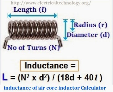

Construction of the inductor:
L=8.44 uH= 0.0000084 H
Simple inductor ecuation design for practical circuits:
L(uH)= (D(n)(n))/((nd/D)+0.44)
*Requieres to add 10% of spires more for adjusts.
D=Internal diammeter of the inductor
n=number of spires
d=diametter of the wire = AWG *(See the table for differents coil diammeter and equivalents).
