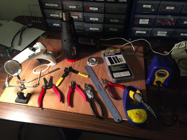

Parts
- 27mm diameter piezo bender, also known as a "buzzer element", such as this part from Digi-Key
- 8" length of 2-lead, shielded balanced microphone cable, such as Mogami W2582
- 1/4" inline female mono jack (sometime called TS or "tip-shield"), such as Rean/Neutrik NYS2202P
- cap from 20 oz pop bottle
Tools
- soldering iron and solder
- wire strippers
- flush cut wire cutters
- 1/4" and 5/16" heat shrink tubing
- hot air gun or candle
- hot glue gun
- sandpaper

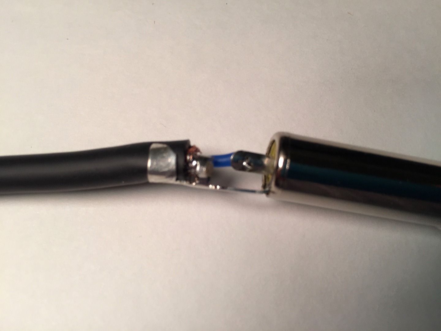

Step 3: Solder Leads to Jack
The jack has two terminals: a signal terminal that goes to the tip of a plug and a shield terminal that goes to the grounded plug housing and the cable shield. The signal terminal is usually a metal tab connected to the body of the jack with a small hole in it. Some jacks may have two signal tabs. If the jack is a mono jack, then you may connect the signal to either one of these. The shield terminal is usually a long strip of metal that may have a folded tab that forms a "pocket" for connecting the ground wires, or there may be a small hole in the bottom of the strip. The figure above is of the pocket variety.
If you plan to do a lot of soldering, it's worth investing in a good iron, as well as a good set of strippers and wire cutters. I use a temperature controlled iron set at 700 degrees with a chisel tip. This transfers a lot of heat quickly and melts the solder fast, which I prefer. There are a number of good Instructables on how to solder.
Before you connect the wire leads to the terminals of the jack, you should "tin" the wires by applying a small amount of solder to the wires. I use a cheap "helping hand" tool with alligator clips to hold my work while I solder.
After you've tinned the wires, put a small blob of solder in the "pocket" of the lead terminal. You should touch the soldering iron to the inside of the pocket to heat it up and then slowly feed the solder into the point where the tip of the iron and the pocket terminal meet.
Now we're ready to connect the wires. Fit the angled end of the signal wire through the hole in the signal terminal and solder it into place with a small amount of solder. Next, slide the ground wire up into the pocket and solder it into place. Use flush wire cutters to cut the wire ends off flush with the terminals. Using pliers, crimp the tabs on the end of the ground terminal to grab the cable housing. When you're done, it should look like this:
Note that there is little excess solder and there is clean separation between the signal and ground connections. It's worth taking your time to get a clean result.
Here's an example of a plug that has a small hole instead of a pocket for the ground wire. To connect the ground wire, simply bend it down to fit through the hole. Note that a large bundle of wire won't typically fit through the hole. To get a smaller bundle snip of half of the shield wire before you twist the shield to the ground lead wire.

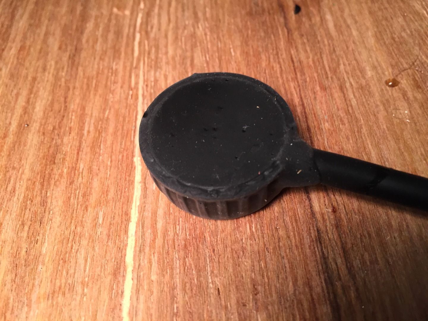

Step 8: Mount in Bottle Cap
Cut a notch into a standard 20 oz drink bottle cap that is big enough for the cable to fit loosely. I do this by first drilling a 1/4" hole on a drill press (hold the cap with pliers or vice grips while drilling), cutting away the excess with wire clippers, and then using a Dremel or file to enlarge. Sand off the nubs from where the bottle cap attached to the ring on the bottle neck.
Apply hot glue over the solder joints and along the joint between the cable and piezo
Apply a generous ring of hot glue around the inside edge of the bottle cap. The glue should come right up to the rim of the cap. Watch your fingers--hot glue is hot!
Set the piezo and cable assembly into the bottle cap so that it is uniformly flush with the rim and hold in place until the glue is firm. It's important that you get it as close to flush as possible, so that the piezo will make good contact with a surface. Apply a ring of hot glue around the joint between the cap and the cable.
Dip the bottle cap and piezo into Plast-Dip just past the joint. Be sure to stir the Plasti-Dip well before you do the dipping! When you dip, lower the mic slowly (take a few seconds) and then remove slowly. Hang the mic by the jack, remove drips with a paper towel, and let dry for a few hours.
You're done!

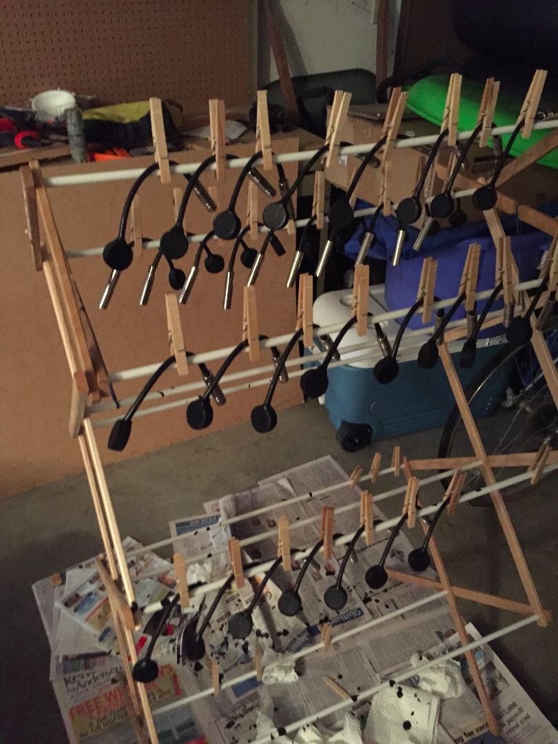

7 years ago on Introduction
wow, how many did you make? i count 30 ish on that rack :D
Nice job. Going to make a few of these, if only for the fun of it :)
Reply 7 years ago on Introduction
We made 55 of them (50 + 5 spares) in 2 batches for Glenn Kotche's "Prepared Drumhead Orchestra". Got a small production line going to strip cable, solder, and prepare bottle caps. Bought the bottle caps online from someone on Etsy--last thing I needed was to drink 55 bottles of soda! Kinda fun, once you get a rhythm going. Many online suppliers (DigiKey, Mouser, etc.) have price breaks at 10 pieces, and quality mic cable can be cheap in bulk, so it's worth making a batch of them and giving them as gifts if you don't need them all.
