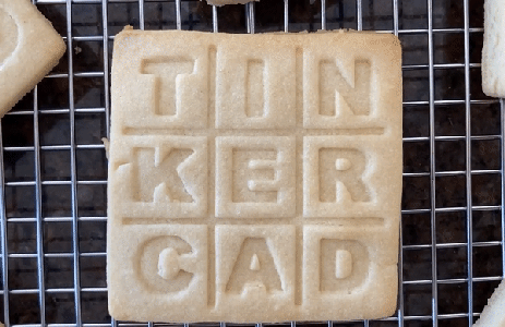

Step 2: 2 Part Cookie Cutter
If you want to add imprinted details to your cookie you can consider doing a 2 part cookie cutter. I found it easier to cut out and then stamp the design with the details rather than do one cookie cutter that does both. It is just too hard to get the dough out of the cutter without tearing it.
Design the silhouette as you just did in the last step.
To design the imprint, make a base the same shape as the cutter (this can be the Default setting - about 1mm thick). Put your design on top of the base and make it at least 3 mm height total (including the 1mm base).
Don't forget to flip your designs when you are ready.

For the 2 part cookie cutters, I cut out a bunch of them and then imprinted them one at a time.
Make sure to push down firmly all around and then peel it off from one side to the other slowly so you don't tear it. Little bits (like inside the A, D, and R) will try to stick. The cooler the dough is, the harder it might be to imprint, but the easier to pull off the imprint without tearing the cookie dough.
Bake and enjoy!
I did about 12 minutes for these sizes at 350 degrees F for these.
