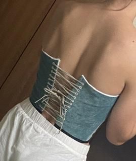

Step 14: Add the Eyelets
Time for hardware! Mark where you want to put your eyelets, roughly 1" apart.
Either cut or punch the holes.
Insert your eyelets into the holes, making sure they are in cleanly. Turn the fabric over, and using an eyelet tool, hammer them into place.
Step 15: Finishing Touches
All that is left to do is attach the straps in back! Lace it up and pin to fit. Then tack them on in back and trim the excess. (Note: it would be cleanest to inset them into the facing, but I got lazy;)
As an optional final step, you can add a modesty panel if desired in the back, which is essentially a strap of fabric which lies behind the lacing to cover up the exposed skin. I omitted that step for this one.
Step 16: Finished!
And voila! You're done!
