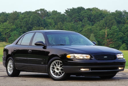

This shows how to turn a grill from a Buck Regal GS ('98) into a custom mesh grill that gives the car the look it so very well deserves. There are many different ways to do this, and I picked the way that looked most like the grill I was copying. You could always have the grill farther back, or even just replace the grill entirely with just the mesh. This was just the best way to get the look I wanted. This could be used for any other car too, just adapt the idea behind it.
Now I did take inspiration for this from somewhere. On the extreme end of modding for Buick Regal GS there is version of the GS called the GSX. And they it looks HOT. The easiest way to know one is the unmistakable "GSX" grill. Now, those neato grills go for $100 on ebay, which seemed too much for me. So I set out to make a grill similar in looks, but inexpensive enough that I would not have to sell any blood or extra organs to afford it.

Put the grill on and see how it checks out! If it looks good, screw it on and you are done. Nice job! I loved how it looked on my car! It gave it a "this car is fast" feeling, without losing the sleeper look of the car. Definitely worth the time and effort.
Afterthoughts; I'm considering making a better cut piece of mesh. I also might put some bondo putty on the rougher parts of the plastic frame, sand that off to get it universally smooth, then paint it and the screen black with some black epoxy paint. I'll update when/if that happens.
One really neat thing about this design is that you can use different pieces of mesh if you get tired of the first one. I'll probably just stick with this however. It looks great!
And as you can see, it looks pretty similar to the GSX grill. And at under $10, and compared to $100... I really like that dropped digit. That'll buy me a lot of ramen noodles.
