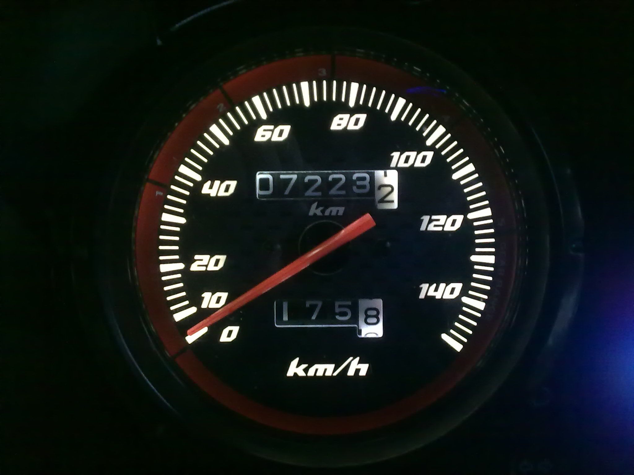

Now you choose what you want to feed. I took advantage and cut the wires of the quadrant, parking light (and later the tail light) to have LED's on these places. It is advisable to use a fuse in the wire from the battery (depending on load).
