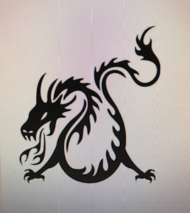

Step 1: Find an Image
Find a stylish dragon silhouette on the internet. Please be honest and pay for the image you download from the internet, if fees apply. This handsome fellow is from Depositphotos Inc.

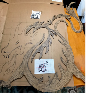

Step 2: Copy the Image Using a Grid
If you have a projector and can project the image onto the big sheet of cardboard to copy it, great! But if you don't, consider the following:
1. Take the image you downloaded and impose 1/2 inch grid lines on top of it. (E.g., using Visio or simply a rule and pen.)
TIP: Using different color lines helps you keep track of where you are in the drawing process.
2. On a large piece of cardboard, draw a 5 inch grid on its surface. Again, if you can use the same color lines as your print out, that will help.
3. Freehand the drawing onto the cardboard, paying particular attention to where the lines of the dragon cross the various grid lines of the cardboard. You'll be amaze at how close you can come to the original drawing.

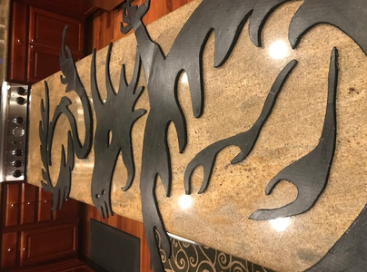

Step 3: Cut and Paint
1. Once you have drawn the dragon on the cardboard, cut it out.
2. Depending on the thickness of the cardboard, a box cutter might work. For thick cardboard, such as the bicycle shipping box I had, a jigsaw worked well.
3. The jigsaw left some rather jagged edges, but a quick rub with a course sandpaper finished the edges nicely.
4. Paint all the pieces: front, back, and sides.

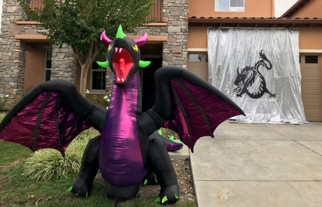

Step 5: Hang the Backdrop and Dragon
I used several yards of very thin, silver fabric that I've used for various backdrops over the last 10 years. It's well worn, wrinkled, ripped, and some of the seams are staples. Any light weight and light colored fabric would do. The opaque plastic sheeting that I rejected would have been fine.
1. Attach the top of the backdrop to a 10 foot, light weight PVC pipe. I sewed the top of the fabric into a sleeve so I could slide the PVC pipe through like a curtain rod.
2. Attach the plastic to another thin PVC pipe (6-8 feet). I made a sleeve out of that with tape, but you could just as easily tape the plastic directly on the PVC pipe.
2. At the top of the shower curtain, poke a few small holes through the backdrop and plastic, up at the base of the PVC piping.
3. Use pipe cleaners or string to tie the backdrop and the plastic together.
4. Raise and secure it to the garage by discreet nails or hooks up near the soffit above the garage door.
5. The bottom of the backdrop and the plastic are not tied together. However, it is helpful to anchor them separately to a PVC pipe or piece of lumber.

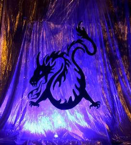

Step 6: Setup the Lighting
1. Depending where your dragon is, you may need to build a 'blind' to raise your lighting closer to the base of the dragon.
Tip: cover the blind with the same fabric as the backdrop obscures it nicely.
2. Place your lighting between the backdrop and the plastic layers. Angle the lights up and a bit towards the shiny backdrop.

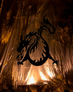

Step 7: Light It Up!
The blue dragon consists of two blue 'flame effect bulbs' in clamp holders and a round Starry Projector Light.
The gold dragon consists of three amber LED Flame Effect Bulbs' in clamp holder.
