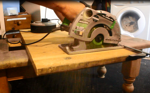

Step 2: Chopping It Up
The first thing I did was make two parallel cuts through the table top using a circular saw fitted with a cutting guide to ensure both cuts were straight and the same distance from the edge. Once this was done there were a few screws to remove before the centre piece of the table top came away. Then I cut through the supports and sanded back where they had joined the legs.

Step 4: Finishing the Top
Then I split the large piece of table top in two according to my earlier measurements. Because the cut was too far from the edge to use the cutting guide, I marked my line and then screwed a scrap piece of timber to the table top to act as a guide to give me a straight cut. A table saw would have been easier but I don't have one of those so I improvised.

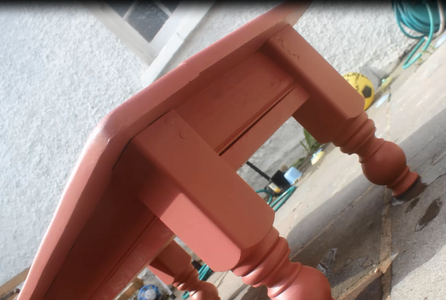

Step 6: Painting
Finally I gave the whole thing another light sanding and painted it all with two coats of an exterior wood paint.
Step 7: Finished
