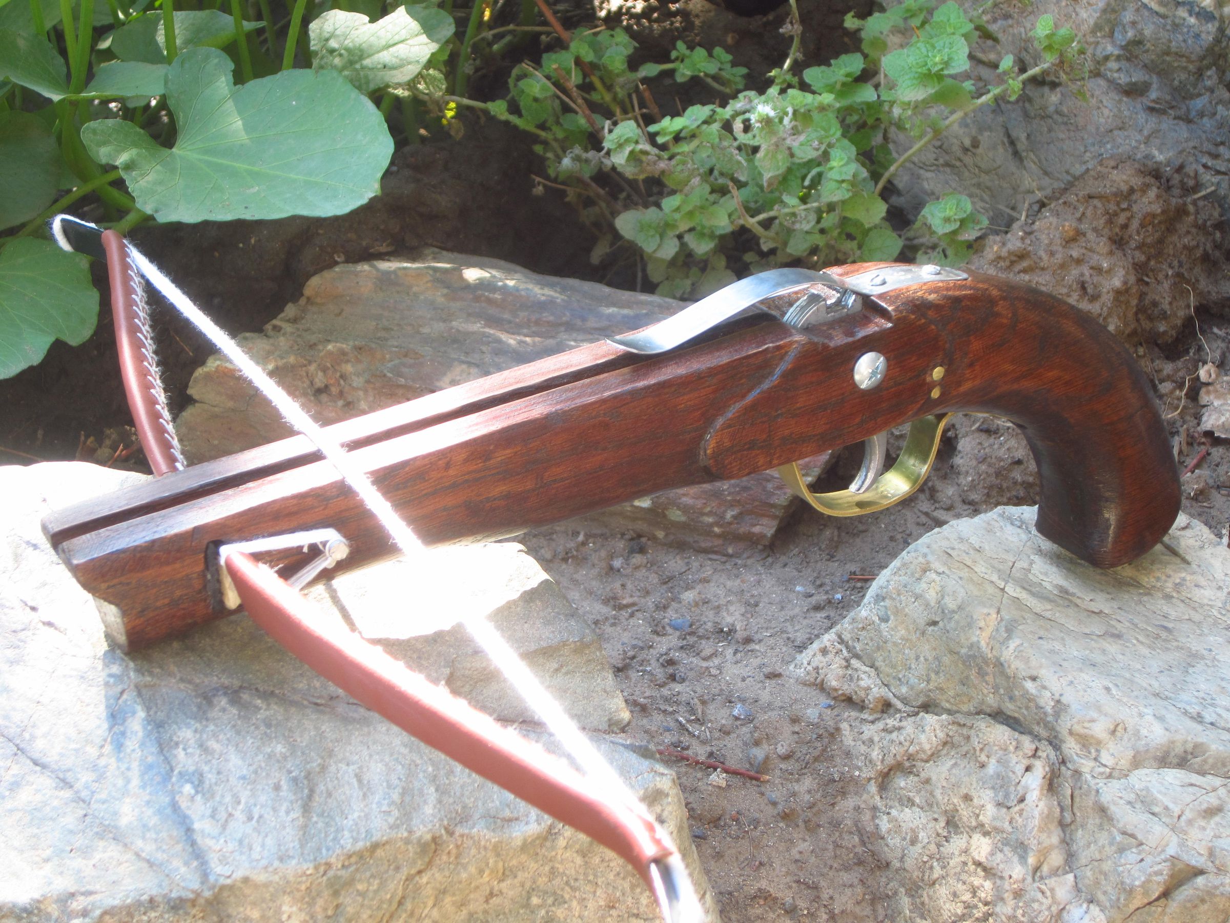

Hello fellow makers, For this instructable I am going to show you how to make a crossbow pistol. I made this project partly for my own interests, but mostly I did it for the awesome people who visit and publish here on instructables.
I realized when researching this project that there was almost no plans for building something like this on the internet, and I wanted to provide a more detailed documentation to serve as inspiration to all of you makers out there. This is an advanced project and I do not suggest that it be undertaken by anyone who is not thoroughly familiar with the basic principles of wood and metal work.
I got a lot of inspiration from This Instructable for my project, but it is too bad the author did not choose to finish it.
I've added diagrams to make this instructable as easy to understand as possible. Forgive me in advance for the low quality pictures used throughout this instructable(Insert lame excuse here). Here it is and I hope you like it.
Note: Every picture in this instructable contains an attached text box, telling what things are and what is going on.

Step 13: Evaluation
Here are the spec's for the crossbow once finished.
Draw Weight: 50lb's
Bowstring: Generic 50lb bowstring available at sporting goods stores and Amazon
Overall Weight of crossbow:1.5-2lb's
Projectiles: Plastic pistol crossbow arrows.
Weight of trigger pull: 15 lb's (Quite heavy trigger pull, so it probably won't go off on accident)
Completion time estimate: 40 hours or so (Someone more experienced could probably do it in less time)
This is my first instructable and any constructive criticism will be welcomed. The building of this crossbow required a great deal of work and there is a good chance I left something out of my instructions.
Disclaimer- You are responsible for anydamage done while using or creating a replica or reproduction of this project. This is not a toy and can seriously injure or kill someone. Use with caution.
