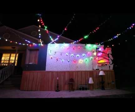

Originally, I planned on having one large moving portrait, but later decided to have two. Once the wall was erected, I turned on the projector to sketch out the holes for the video.
Using a jigsaw, I cut rough openings for the portraits. I then used door casing to frame out the portrait holes. This gave it a nice finished edge and resembled a photo frame. For the projection material, I simply cut a bed sheet and stapled it to the back of the plywood. Make sure it is tight to prevent sagging or wrinkles.

These are images from my test. Ignore the dark lines, the window was closed during testing, and those are the slats between the window panes. I left the video paused on the nights before Halloween, changing them slightly from night to night. I didn't want anyone to know they were animated until Halloween night.
Step 6: SUCCESS!
The wall was a huge success as part of our Harry Potter theme. It turned our 2 lane road into 4 lanes of traffic. Everyone stopped to watch the portraits change and loved them! The walls will definitely make a return visit for Halloweens to come.
