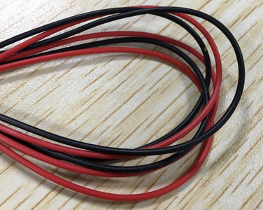

Cable*N

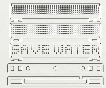

3mm black opaque acrylic
3mm transparent acrylic
Step 2: Laser Cut Acrylic Panels
There are parts of the text for transparent acrylic, other for black Opaque acrylic, and do not cut the text part, please use the scan.
