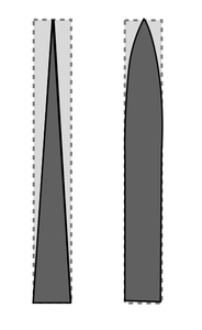

Before you do anything else, you must come up with a design for your knife. I based my design off of several kitchen knives I already had. I made several changed like the angular part by the tip instead of a smooth curve, and Im using an African rosewood called bubinga instead of the black wood/plastic for the handle piece. Otherwise, its basically the same knife: 1/8 inch thick blade, 5.5 inch handle, 6 inch blade. My first sketch was half-scale on an engineering pad, and then I did a full scale one to make sure the size felt right, etc. As you can see, it took me several tries to get the handle shape right.
There are also some differences in the metal itself. First of all I'm using 0-1 tool steel, and the other knives are stainless, but the other knives also have some metal flange things at the front of the handle, a feature thats impossible to create if you are just using a piece of flat bar stock like I did.
Anyway, these are just some things to consider.
