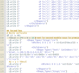

Step 1: Python Program
I first looked online to see if there already exists any means of creating cutting templates for cardboard boxes. Surprinsingly, there are many that I could use, and I tried a few of them.
But I found them too complex for my needs, so I decided to make my own, very simplified but suited to my needs. It is a short Python script that generates a file that is readable using the Litghtburn laser cutter control software.
Lightburn reads files that describe both the geometry of the object to be cut AND the cutting parameters, such as
  • Laser power (0 - 100%)
  • Cutting speed
  • PWM (Pulse-width modulation): this is used to create folding lines (see below)
The file looks like an xml file: Extensible Markup Language (XML) is a markup language that defines a set of rules for encoding documents in a format that is both human-readable and machine-readable. After saving it in a dedicated folder, I open it using Lightburn, select the shape of the box, and cut it with the laser cutter.
Step 2: Generate the Box Geometry
Download the 3 files and put them in a given folder. Edit the python file and modify the first line:
path = "D:\\Lightburn\\Cartons\\"
to put the path of the folder. All the created files will appear in this folder as well. Their name should begin with 'Box' followed by the dimensions and the extension '.lbrn'.
The python script generates 2 box geometries: landscape and portrait style. Choose the one you prefer, according to the dimension of your cardboard, and send it to the laser cutter. The laser power is adapted for the 100W CO2 laser that I use. If your laser's power is lower, you may have to change this accordingly. For example, if you use a 80W laser, you will have to divide the power value by 0.8

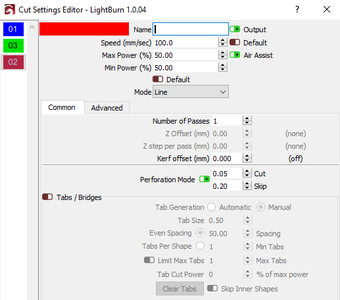

Folding lines use PWM settings of the laser cutter (see 'Perforation mode' in Lightburn): the laser machine makes a bee-like noise at this stage, but do not worry about that...
Perforation Mode
If you are trying to cut fold lines in card stock, stitch holes in leather, or just make dashed lines, perforation mode allows you to choose the distance to cut, followed by the distance to skip.
Here the settings are 0.05 Cut and 0.20 Skip.

EDIT2: If the cardboard is thick, you may want to double the paths of the laser. To do this, double click on the parameters of the layers ("Cuts/Layers" window) and increase the "Number of passes" to 2. Then click OK.
