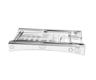

This step is flexible depending on the tools and capabilities you have access to. If you have a 3D printer, you can print out an adapter that I designed.
Solidworks and STL file attached.
It has four countersunk holes to capture it to the megaphone through the same screw bosses of the handle, and it has holes to zip-tie it to the helmet. This is to prevent screwing through the thin plastic of the helmet.
