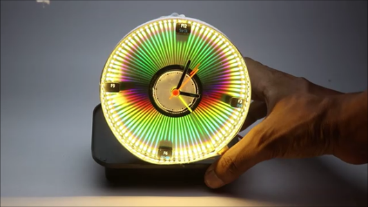

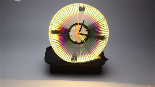

Hi readers in this instructables i will show you how I made this light pattern clock that changes its color when viewed from angles using upcycled materials
This Clock is special because it produces different colors of light when viewed from different angles

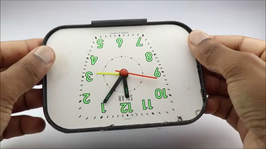

I was looking my old boxes to check if i had any thing to make some interesting stuff for my desk, an old clock that had the front shield broken, and no longer fit to use directly caught my attention!
I cleaned the outside part and wanted to check if the mechanisms still works, when i inserted the battery it started to make that click click sound, then i decided it to give a makeover and change it completely.

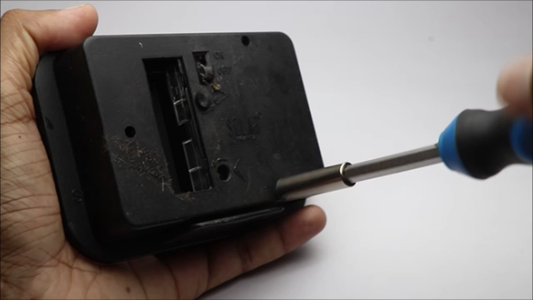

Step 1: Scavenging Clock Mechanism
The mechanism as well as the body of the clock were used in this project, so make sure you carefully remove the parts without damaging any of the parts.

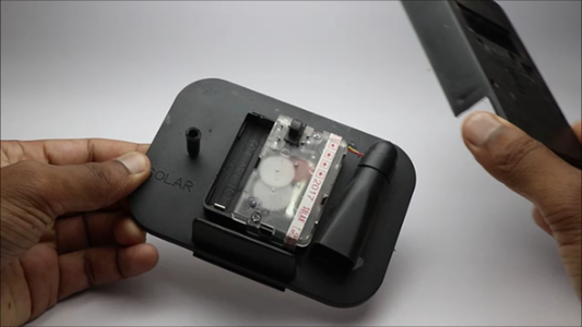

I started by removing the screws at the back followed by opening the panel.
I saw the machine that runs the clock, this was attached to the frame using 2 screws, I removed those then I was finally able to separate the mechanism.

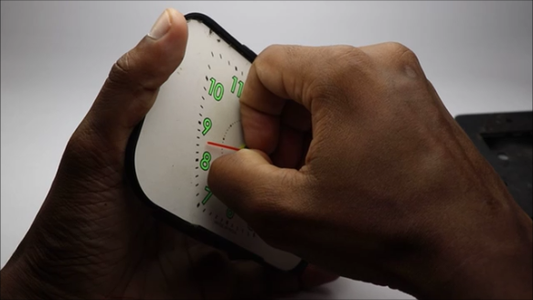

Now before working any further remove the pointers/needle of the clock.
I did not want to miss anything so i wrote down where exactly the pointers were placed on the machine.

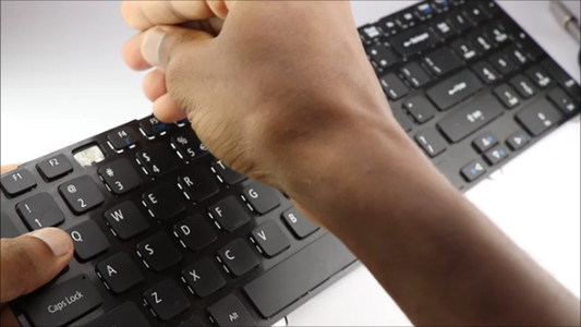

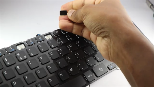

Step 2: Clock Dials
Dials are the ones that help us identify where the needles are pointing.
I recycled the numbers on the keyboard that was no longer in use.
I used function keys as o found that the size of these are a good match compared to the size of the frame we are using.
It is very easy to pull out the keys, pull out 3,6,9 and 12.

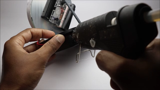

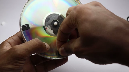

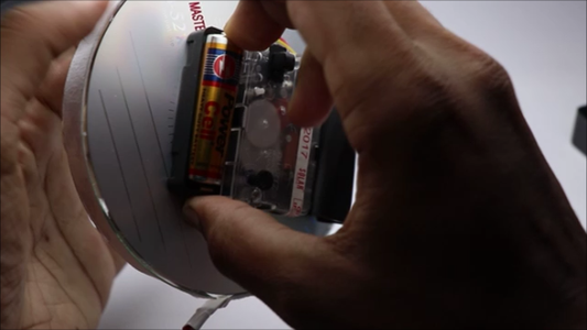

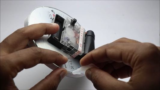

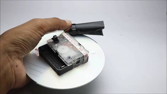

Step 3: Adding Mechanism to the CD

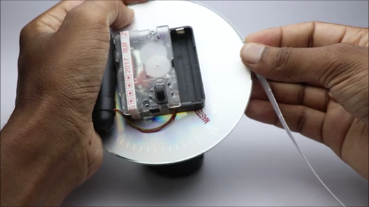

Add few drops of superglue to the back part of the CD.
Now gently place the machine of the clock on this, make sure that the glue does not touch any parts of the actual moving part.
Hold it tight for a few seconds until the glue dries and there is no chance of side spillage.
In my clock i had a buzzer for the alarm, even i used superglue to stick this to the back part of the CD

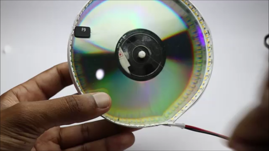

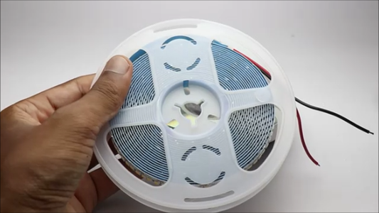

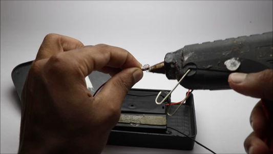

Step 4: Adding LED Strip

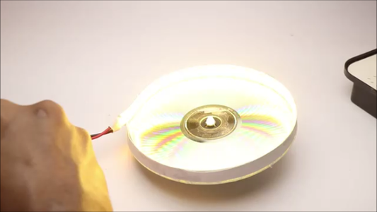

As the corners of the CD is very thin we can't add the LED strip directly, so i cut a strip of paper and later glued to the edges of a circle.
This has to be done neatly, any amount if extra glue would spoil your cd and leaves impressions that are very clear to see when the LED bulb glows.
Glue the strip to all the ends, now cut the same length led strip and using the double sided tape given in the LED stick along with the inner surface.
Finally check if the connections are correct by connecting batteries to the LED strip.

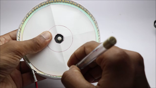

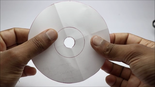

Step 5: Adding the Dials

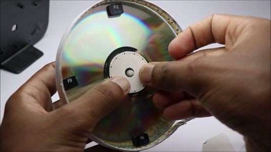

Before marking the dials we need the exact points where it has to be marked.
To do this i have the circle slightly smaller than the diameter of CD.
Cut the center holes, now fold the paper to get the center point.
As we can see now we have 4 lines each indicating quarter of 12 hours.
Place this on the surface of CD and mark the points.

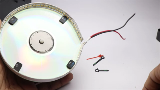

Now to the marked points add a drop of glue and stick the keys/dials
Repeat the same for other 3 dials.

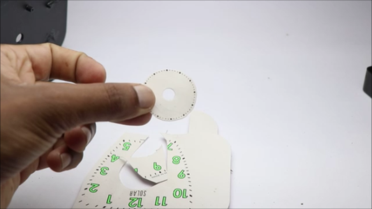

Step 6: Adding Pointers
Pointers or needles that we removed earlier with a note will be useful now.
To add more details i made use of the dotted type of paper from the old clock face.
I made use of the center part only, i sticked that to the center part of CD as you can see from the visuals.
After this is dried completely, we can start to add pointers one after the other.
Check if everything works fine by adding a battery to the clock machine.

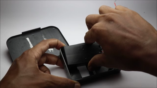

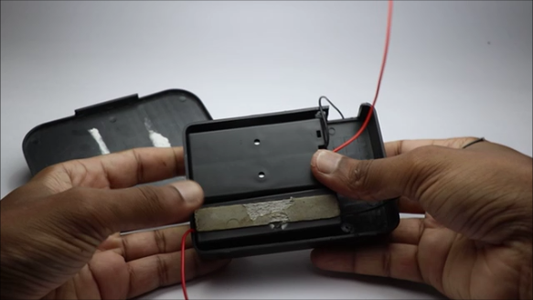

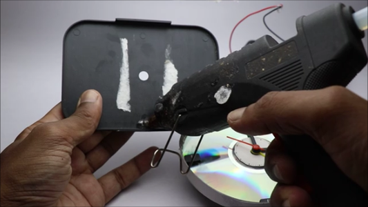

Step 7: Assembling the Body
As i mentioned earlier i used the body of the clock, The space inside on the type of clock i used could fit 3 of the batteries perfectly.
I used 2 battery holders, one holder hold single battery and other holder holds 2 battery
The battery holders were connected in series later giving a total output of 11v
The LED strip glows at full bright at 12v, but we are giving 11v that s good for the life of LED's!
To elevate the clock i made use of a small stick and later i finished the circuit by adding a switch.

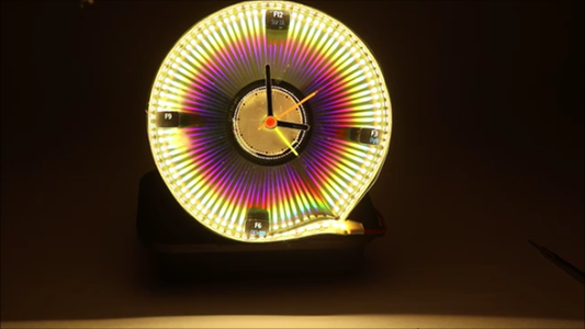

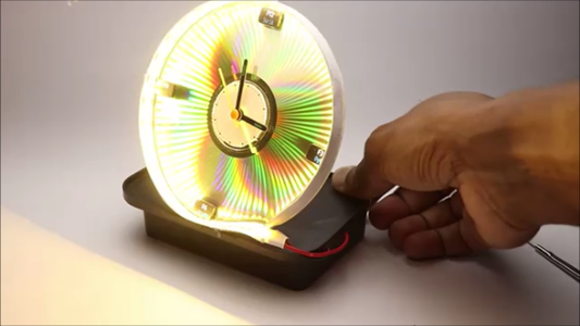

Step 8: How to Use
Using this project is very fun and you can impress your friends with this
To use this project all you have to do is insert the battery into the clock if you have not inserted, set the time.
Switch on the power supply with the switch given at the back, now you will see that glow of light.
You can adjust the position of the lamp as per the way you like it.
You can switch it off when not in use, note that the batteries are rechargeable, whenever you want to recharge just take it out from the holder, charge it using the charger and put it back.
