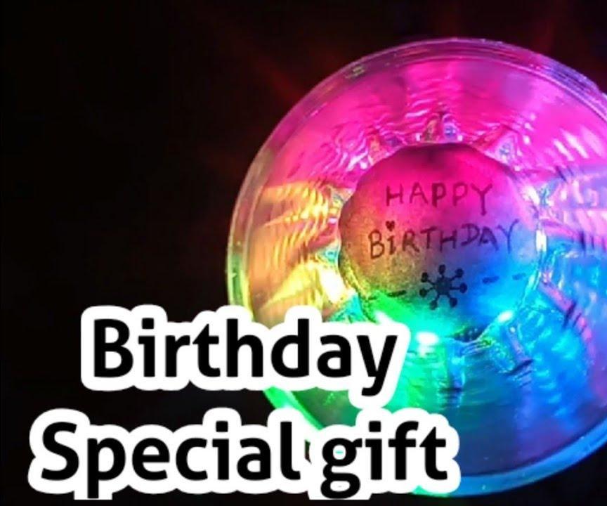

Step 1: Dead LED Bulb
Take two dead LED bulb. We need two LED bulb upper white cover. So we will unmount the bulb cover from LED.
Step 2: Paper Design
Now we will cut a square sized sheet from the thick cardboard paper. Cut a circle in the square sheet as shown in below image. So on make one more same sheet.
Step 3: Design of Body of Light Box
Then we will arrange the bulb cover in the hole of this sheet as shown in below image.
Mount the bulb cover on it tightly
Step 4: Circuit Playground Microcontroller
After doing this take 2 circuit Playground board and attach cable in both one by one.
-> About circuit playground-
It is a new type of microcontroller that we are using. This microcontroller belong to adafruit. In this microcontroller there are 10 multi-colored led, temperature sensor, light sensor, sound sensor and different more are already fitted. And to make code in circuit playground is also very easy due to it's drag and drop programming. You can also code it in JavaScript.
Step 5: Attaching LED Board With Design
Now mount a double sided tape on the mouth of cable connector and attach it with sheet as shown in below image. Attach the circuit playground in the middle of the sheet tightly
Step 6: Code
Now the whole parts arranged successfully and now we have to just upload the code in it.
Code file is already given in this tutorial. Or you can also paste below code in the JavaScript section of make code editor.

Step 7: How to Upload
-> How to upload code-
Press reset button two times continue then upload the code in circuit playground. After that our Music Reactive light box is fully ready and ready to test. Let's power it and test it now...
See the video tutorial on first part in which you can see the testing of this project.
Step 8: Let's Test
