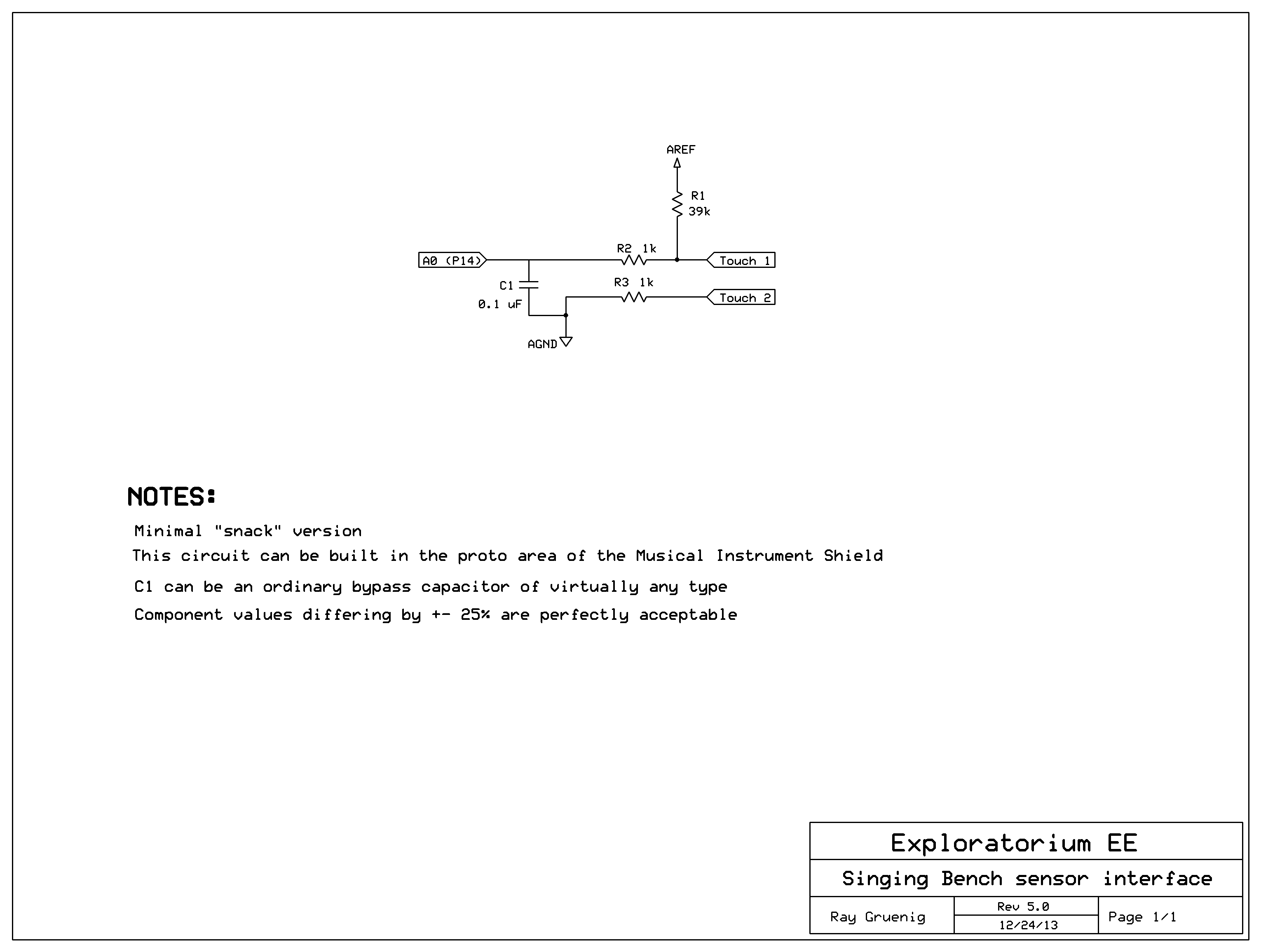

If you're familiar with schematics
Here are two schematics that should help most experienced arduinio/electronics people figure out how we're making. One is a drawing of the connections done with Fritzing, and the other is an electronics schematics of the sensor interface.

Step 3: Add Your Resistors
- Orient your shield so that you're looking at the side with the components on it, and the text "Sparkfun.com" is right side up.
- Place the three resistors next to each other in the center of the prototype area of the Musical Instrument Shield. Place the 39k resistor on the left—we'll call this R1. Place one of the 1k resistors in the middle (R2), and the last 1k resistor (R3) on the right, nearest the audio jack. It helps to spread the legs with two spaces in the middle so that the resistors can lay flat.
Flip the board over. Solder each leg into place. Don't snip the ends yet.
Cross over the legs of R1 and R2 on the side closest to the audio jack and solder them together.

Step 5: Add the Red Wire
Now you will add three wires to the board. To keep them easily identifiable we've used red, white, and black but the color of the wire doesn't matter.
Cut a piece of solid core wire (we used the red one) about 2” long and strip both ends.
Insert one end into board right next to C1 and directly above R1.
Flip over the board and solder that end into place.
Bend down the leg of R1 (the side not connected to R2) and solder it to the red wire.
Flip the board back to the front and insert the other end into the header socket labeled “AREF” (it is on the bottom left side of the shield).
Step 6: Add the Black Wire
Cut a piece of solid core wire (we use black) about 2" long and strip both ends about 3/8".
Insert one end into the board just above the C1/R3 junction.
Flip the board over and and solder the end into place.
Make a soldered connected to the adjacent C1/R3 junction.
Flip the board back to the front side and insert the other end of the wire into the header socket labeled "GND" (right above "AREF").
Step 7: Add the White Wire
Cut a piece of solid core wire (we use white) about 3" long and strip both ends about 3/8".
Insert one into the board just above the c1/R2 junction (just to the left of the black wire)
Flip the board over and solder the end of the wire in place.
Make a soldered connection to the adjacent C1/R2 junction.
Flip the board over and Insert the other end of the wire into the header socket labeled "A0" (on the middle right side of the shield).
Step 8: Connect the Wires for the Touch Pads
Cut two pieces of the stranded wire as long as you will need to reach from the shield to where you want the touch pads to go.
Strip back 1/4" on one and insert just below R3.
Flip the board over. Solder the wire in place and make a soldered connection to the leg of R3.
Go back to the front of the board. Strip back 1/4" on the other wire and insert just below R2.
Flip the board over. Solder the wire in place and make a soldered connection to the R1/R2 junction.
