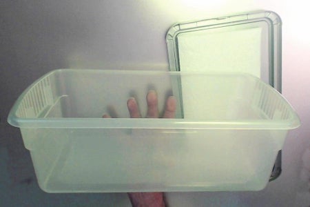

- A waterproof container. I used a plastic shoebox.
- Water. It's very handy to have something to pour from, rather than using water directly from the faucet.
- A place to dry the sheet. I used the lid of the plastic shoebox, lined with a paper towel.

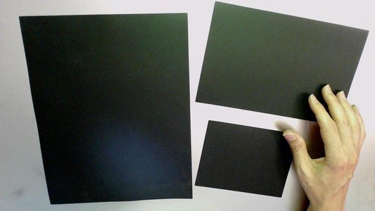

- Use matte black construction paper, card stock, or presentation cover.
- If you're using a plastic shoebox, then half of an 8.5"x11" sheet (i.e. trimmed to 8.5"x5.5") works very well. If you have a larger container, you can use a full sheet (but construction paper can become hard to work with or tear when wet). If you want more people to make their own (without buying more paper) and/or want smaller results, you can quarter the sheets (i.e. trimmed to 4.25"x5.5"). If you do, some nice parts of the nail polish may fall beyond the edge.
- Cut slots along the short edges of the sheet to fold up as "handles". Cut roughly a half inch in from those edges, and leave a roughly one inch portion that is not cut.
- Fold the "handles" together, and secure them. I used binder clips.

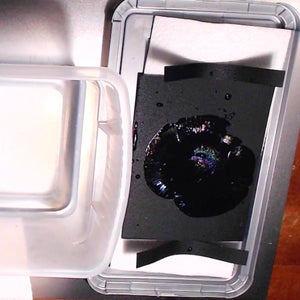

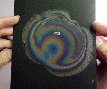

Step 3: Make the Nail Polish Film
- Get a drop of nail polish to fall over the center of the sheet.
- If you try to drip or shake a drop out directly from the nail polish brush, you want the brush to hold as much nail polish as possible - otherwise, the drops tend to be too small. It's tricky to get the drop to fall where you want it, but you can do it, with practice.
- If you use a narrow drinking straw, dip the straw in to a depth slightly less than the diameter of the straw, then cap the top of the straw with your finger so that the polish is trapped in the straw. Then, lead the straw over the center of the sheet before removing your finger from the straw. If you're not careful, it's easy to transfer far too much nail polish, making a film that's too thick to see the colorful patterns.
- I like the control you get when using plastic droppers. (They're a very common item, available from many sources.) If you use them, single drops gently dripped are almost always too small to see many colors. So, either drip 2-3 drops very rapidly, or "sqirt" out the equivalent of 2-3 drops. Or, trim the plastic back to a slightly thicker section so that you get a larger drop.
- For even greater control, use just over 0.1 mL from a small plastic syringe, such as these from American Science and Surplus.

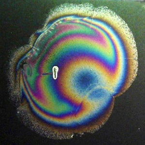

- Watch as the drop spreads on the surface of the water, forming a rainbow-like series of rings. (Some types of nail polish take a few seconds.)
- If you want to use the dropper later, drop the remaining nail polish back into the bottle.
- IMPORTANT: Wait for the film to completely dry, before lifting your sheet out of the water. This usually takes a few minutes. If you lift it out too soon, the pattern will fade or become nearly invisible as it dries. Some types of nail polish wrinkle slightly as they dry, helping you identify sections as they dry.
- After you're sure the film is totally dry, use the handles to gently lift the sheet through the film.
- Transfer the sheet with your rainbow film to dry on the paper towels placed on the shoebox lid.
- If you plan to make more films in the same container of water, it may be helpful to skim off any remaining nail polish using paper or a paper towel. You may also want to change out for fresh water, since card stock and construction paper leave some color in the water.

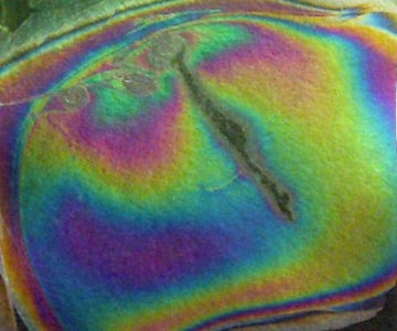

Step 5: How Does This Work?

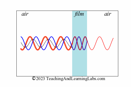

For many observations, light behaves as a wave. ["What light is" gets stickier once you consider quantum mechanics. But for this, we'll be OK thinking "light is a wave."] Different colors correspond to different wavelengths.
As with any wave (sound waves, water waves, waves in strings), when they interact, they "add" by superposition. If they're both "up", then the result is higher than either one alone; if both "down", then lower then either. But if one is "up" and the other "down", they tend to cancel each other out.
And as with any wave, any time they hit the boundary between two materials, some will reflect back, and some may be transmitted. With thin films, you get reflections from both the front and the back. This creates the two waves that interfere to produce the colors you see. That is: for a given thickness, some wavelengths (colors) will cancel; the reflected color you see is a proportional blend of what's left.
Some very good images and interactives are available on the web, but there are also plenty that are confusing or incorrect.

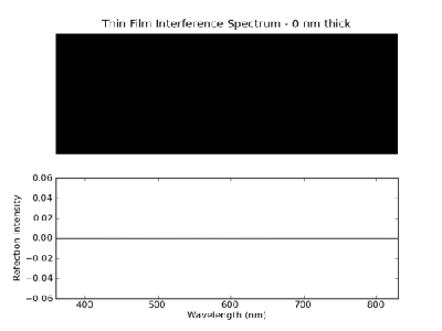

My animations in this step show the waves as they're transmitted and reflected from each boundary. The first keeps the wavelength (color) of the light constant while changing the thickness of the film - for each wavelength, the reflection will be strong for some thicknesses, while at other thicknesses there is no reflection at all. The second animation keeps the film thickness constant while changing the wavelength. Note that the colors in the animation are to help you identify which wave is which - they all represent the same color of light. [TALL notes: these aren't perfect: the amplidute of each wave is reduced at each boundary - which I indicate roughly by the thickness of the line. Also, the behavior very close to each boundary is more complex.
If you want to see the same effects interactively, please check out
https://www.geogebra.org/m/ZzUQnmjB and
https://loganms.github.io/ThinFilmInterferenceSimulation/

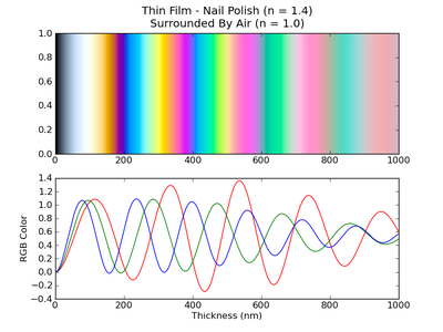

The resulting intensity vs. film thickness for assorted colors can be seen at
https://www.geogebra.org/m/mSv7zFxu
Our brains blend the resulting reflected colors together into what we perceive as a single color. That is approximated at
http://markkness.net/colorpy/ColorPy.html (which I used to generate the image above) and
https://demonstrations.wolfram.com/ThinFilmInterferenceSpectrum/
For all of the above, use for the index of refraction n1=1 (air), n2=1.4 (approximate for nail polish), and n3=1 (air); or if that's not an option, use "Num phase flips"=1

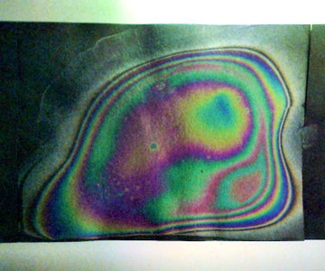

As shown in the first figure, you can quickly glance at your film and for some colors, you can immediately identify how thick the film is. Using nothing but your eye and your sense of color, you can say, "The film is 210 nanometers thick there."
For some of the colors, it's hard to tell exactly how thick the film is just by looking at the color. But you can easily use light to find differences in film thickness.

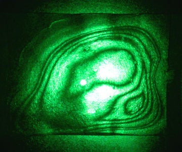

You may have noticed in the animations above that there was a fairly broad range of thicknesses that gave a significant reflection, but only a narrow range where the reflection cancelled, for any one wavelength. So, if we shine light that's just one wavelength onto a film that varies in thickness, we see broad bright stripes separated by thin black lines.

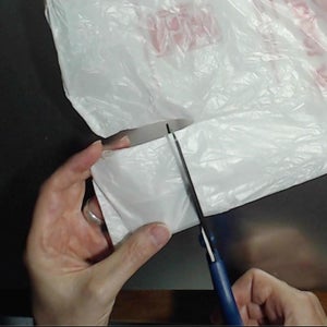

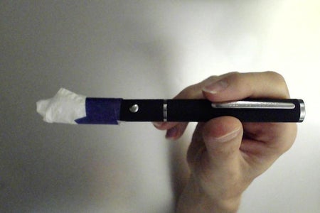

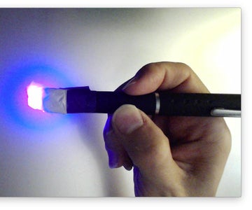

Fortunately, lasers are common light sources emitting just one wavelength. We want to shine the light over the entire film rather than just one spot, so we need to spread it out. Here's a method that works well:
- Trim small squares from several layers from a white plastic grocery bag. (Trimming about 2 in. x 2 in. from a corner usually works, since you can then use anywhere from one to four layers.)
- In a dark room, press pieces of the bag against the laser pointer. You want the light to be bright, but spread out. Decide the number of layers you want to use.
- Use tape to hold the pieces of the bag in front of the laser pointer.
- Shine the light from the laser onto your film.
These figures show the same film in white light, and light from red, green, and purple laser pointers. The difference in thickness from one dark stripe to the adjacent stripe is one wavelength of light . In air, red lasers have a wavelength around 650 nanometers, green around 530 nm, purple around 450 nm. (The exact wavelength depends on the way the laser diode was made.) The wavelength in the film, is this value divided by the index of refraction of the film. Once you know the wavelength of your laser, you can use it effectively as a ruler to measure incredibly tiny distances.
This also lets you take advantage of thick films: films more than around 1000 nm thick produce interference colors that are very hard to see in regular light; but when lit by laser light (especially green), many dark and light stripes are very clear.
