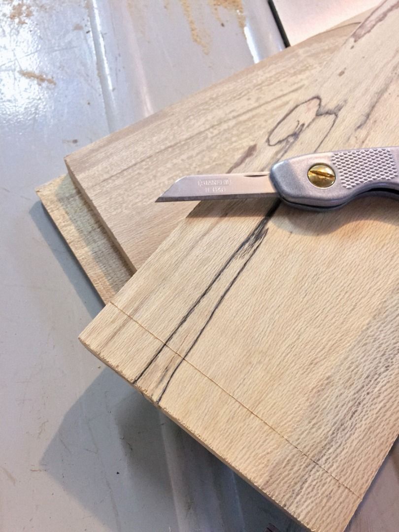

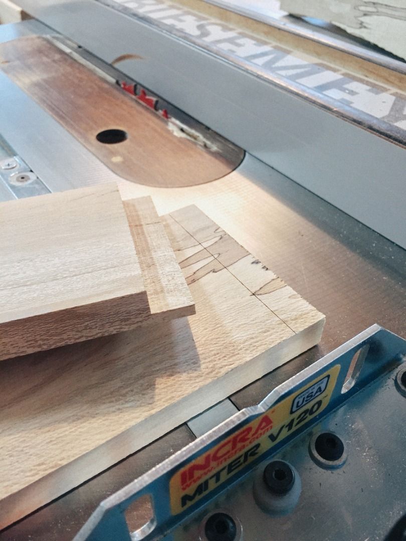

For the corner joinery, I decided to cut rabbets. Before cutting, I scribed a 'knife wall' to eliminate blowout.
For the bottom, I cut a groove and left space for wood expansion. Since this piece is so small, it shouldn't be too much trouble, but it's a good habit to always keep this in mind when working with solid wood.
