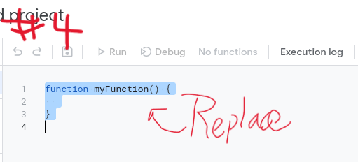

  4. Within the code window, replace "function myFunction(){}" with the code located below the steps

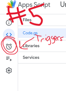

  5. At the left side of the Apps Script page, navigate to the "Triggers" tab

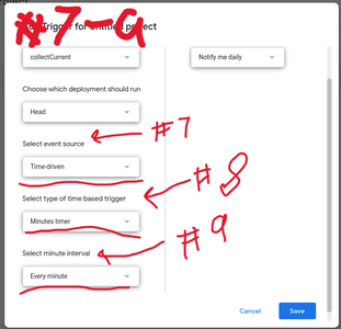

  6. In the "Triggers" window, at the bottom of the page, press the blue "Add Trigger" button
  7. Within the trigger setup window, move to "Select Even Source" and select "Time-Driven"
  8. This will create a new drop-down menu: "Select type of time based trigger", select "Minutes timer"
  9. Under "Select minute interval," select "Every minute"

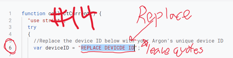

  14. Back in the code window, paste the Device ID into the sixth line of code within the quotations where it says, "REPLACE DEVICE ID"
