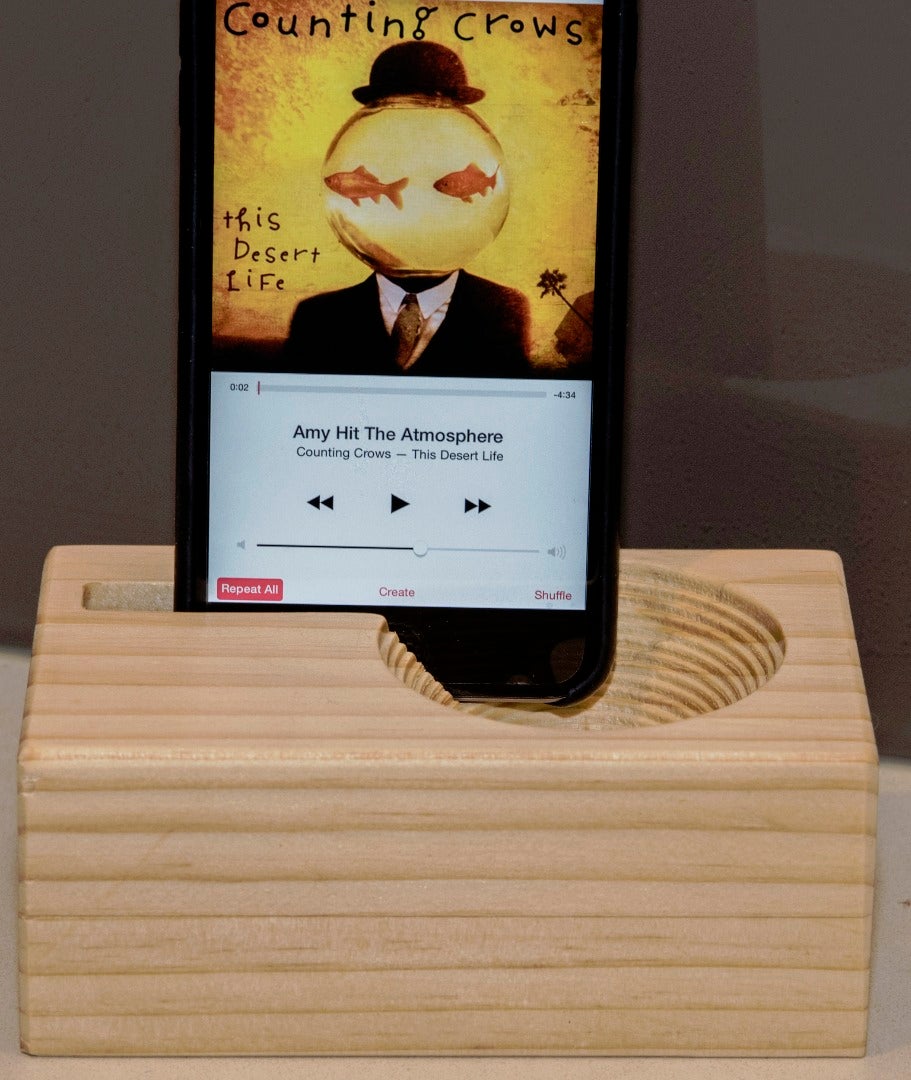

For the workpiece i just used 2 pieces of framing timber about 150mm long and laminated them together, i smoothed them up with a handplane
Step 3: Carve It Out With the X-Carve CNC
Press Carve in easel.com and let the X-Carve cnc machine work its magic and carve out the cone and phone holder.
Step 4: Apply the Finish
Sand the project and then apply some Danish oil with a rag, Danish oil gives a nice close to the wood feel. Danish oil is a mix of tung oils and varnish.
I also used a Veritas block plane to chamfer the edges
Step 5: Last Step
Put your phone in and listen to some sweet tunes.
