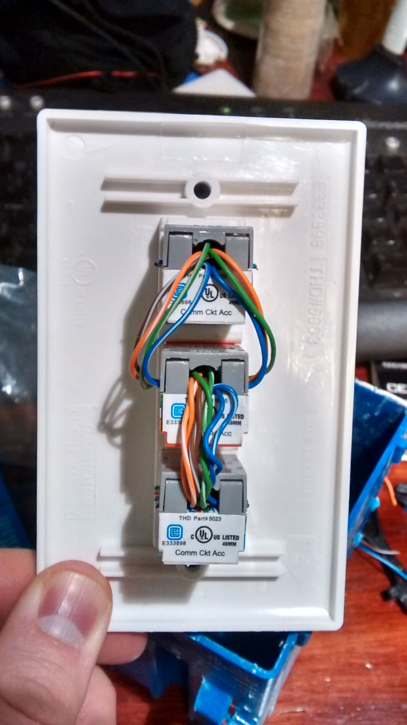

Step 4: Wire the First Jack
Separate the strands of wire and wire up the leviton jack. It comes with a little punchdown tool to make this job easy. I followed the color code on the side of the jack, it does not really matter though, as long as you are consistent the whole way through.
Step 5: Wire the Second Jack
To wire the second jack, you should put both the jacks in the wall plate.
Use the punchdown tool to put the wires in the jack using the color codes or same pattern as you did on the first jack. Make sure to leave enough wire left over to reach the third jack.
Step 6: Third Jack
To wire the third jack, drop the third jack in the panel then wire it up just like the 1st and 2nd.
Trim any excess wire.
Step 7: Close It Up
At this point you can close up the box and you are done.
Test it by hooking up the input in the top jack, snooping interface in the middle, and the destination on the bottom.
You can start up your snooping program and watch the traffic spin by. Make sure to have the snooping interface set to promiscuous mode and not assigned an ip.

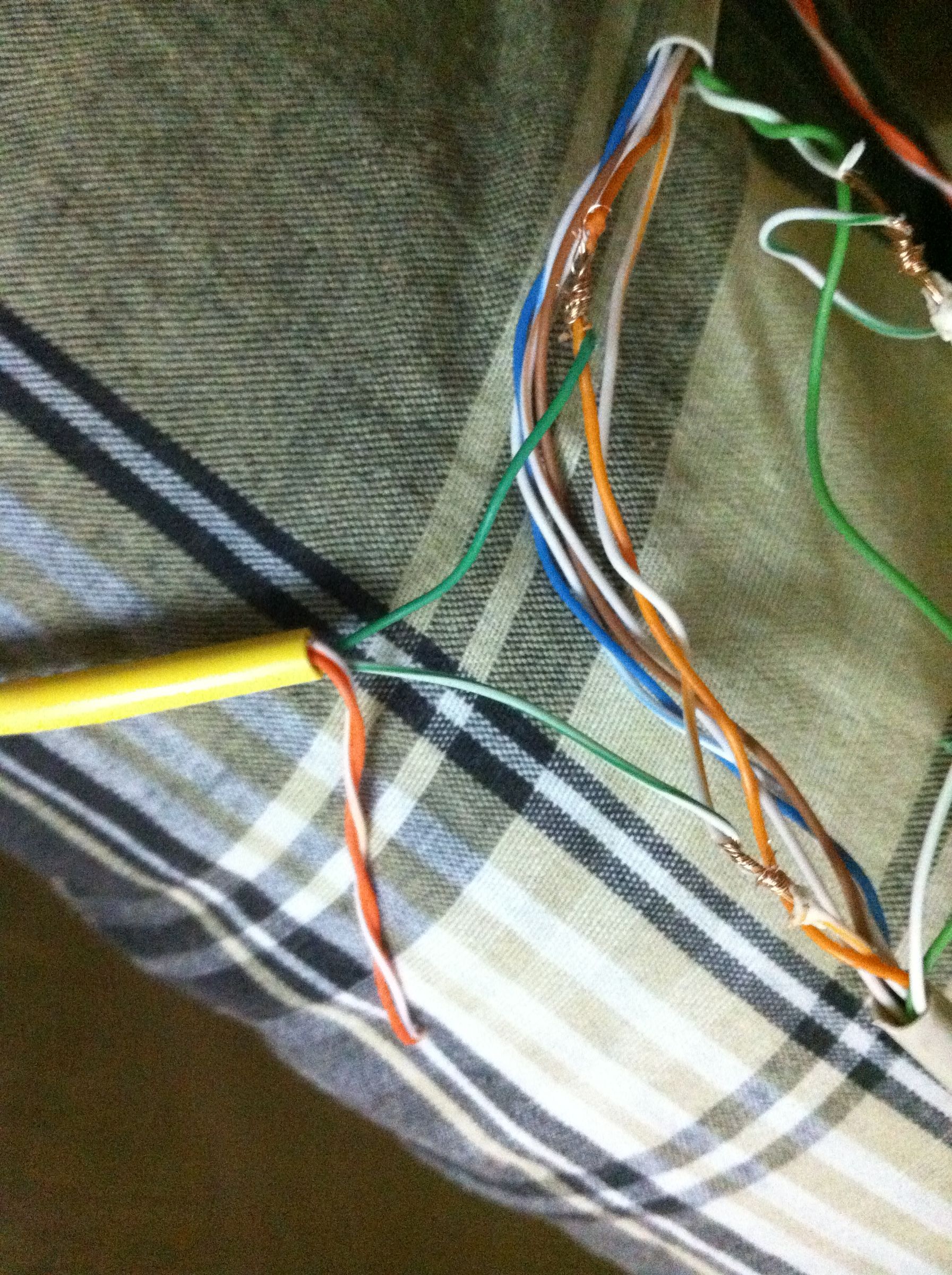

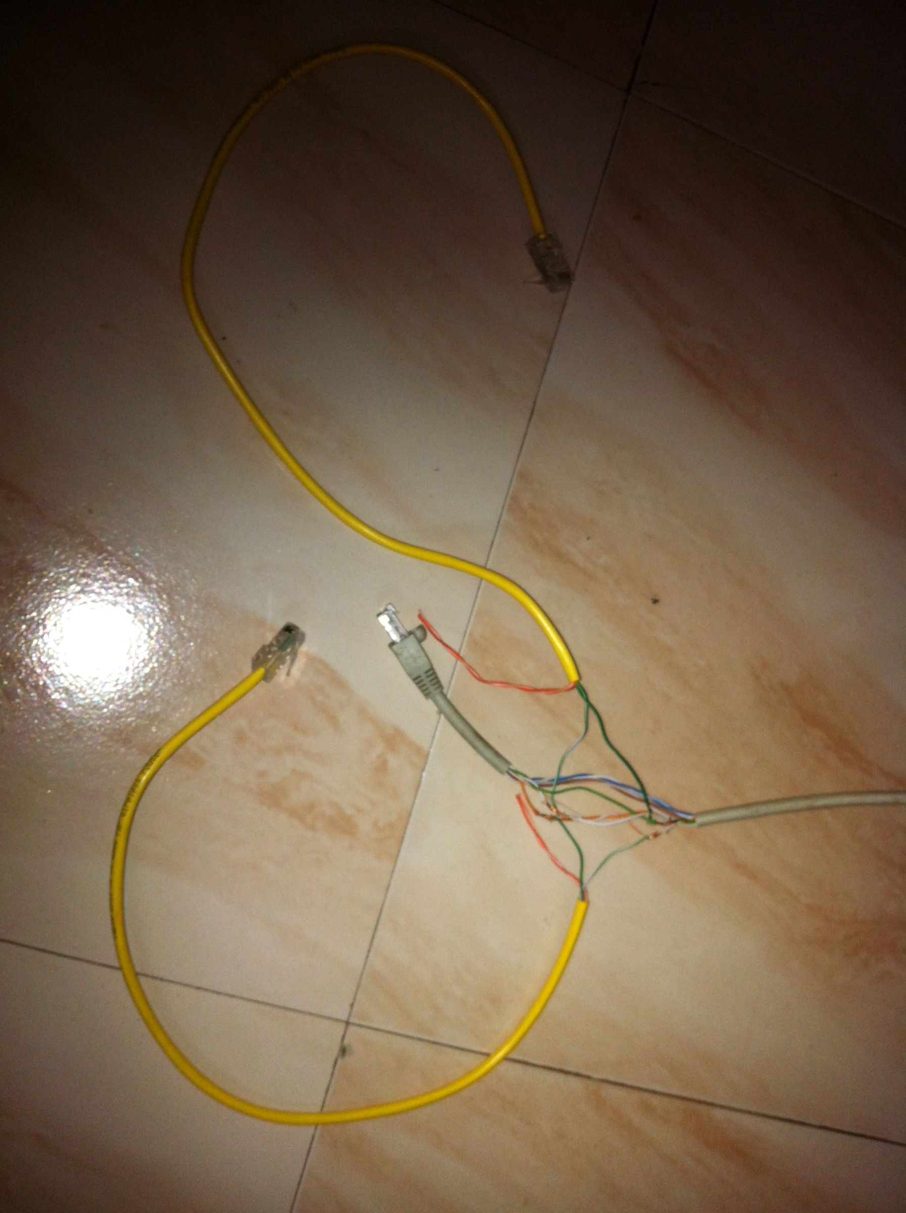

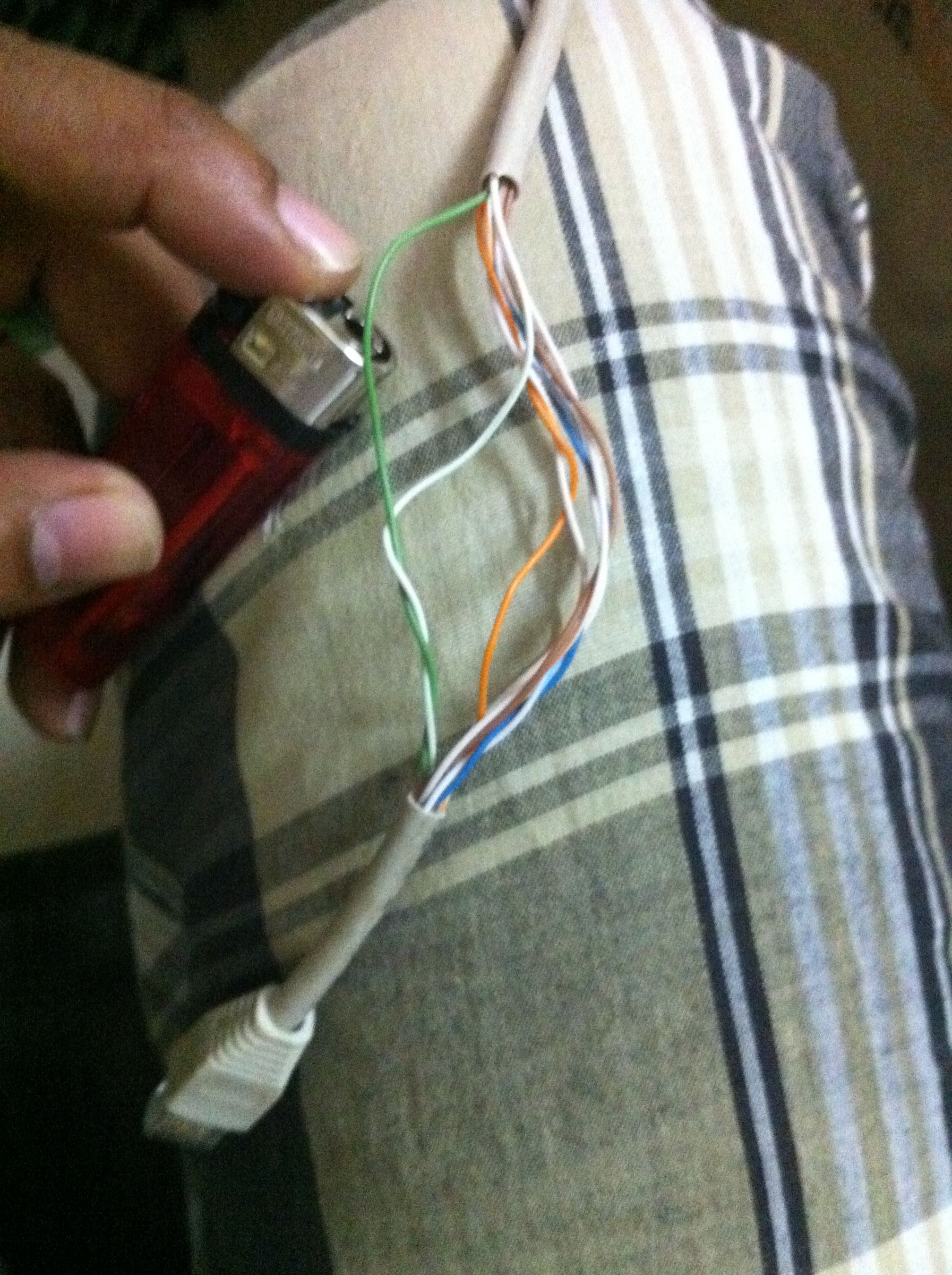

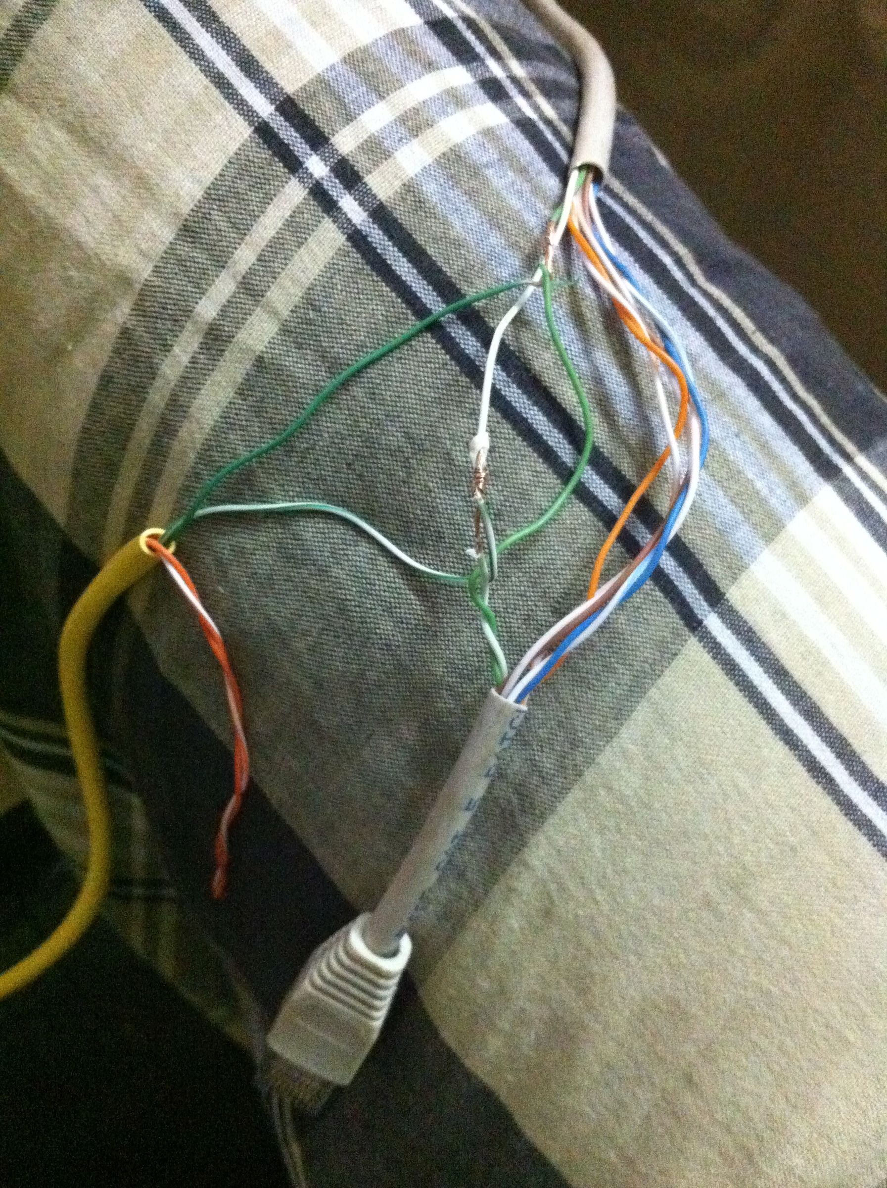

cheaper still use 2 cat5 RJ 45 Cables..
cable 1 is host.
cable 2 is tap.
Cut cable2 in half . use a lighter to burn off some of the plastic insulation on the ends
green wire and the green&white wires on both halves.
Remove some of the grey sleeve on cable 1. burn off the insulation on the green&white, green, orange&white and orange wires.
now connect the green&white wire from cable 2 to the green&white wire on cable 1. insulate with electrical tape.
connect the green wire from cable 2 to the green wire on cable 1
connect the green wire from other half of cable 2 to the orange wire on cable 1
connect the green&white wire from other half of cable 2 to the Orange&white wire on cable 1.
use marker pen to identify host , tap A and B
cheap and simple.
remove the cable from your PC and Router and replace with cable 1
plug end of cable 2 into another computer with wireshark etc. running . you now have a passive tap.
image grey cable host.
yellow cable tap.
