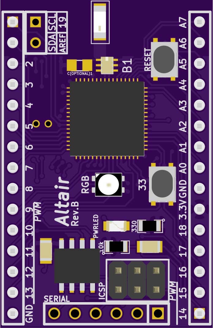

We are going to use an Altair: It will have connected a AC adapter and a SERVO motor.
The actions the Altair will have are going to be:
- Serve a little bit
- Serve half
- Serve a lot
- Toggle (manual)
The only difference among the modes are the time the servo motor will take being open, also, the aperture. Additionally the manual mode was created in order to clean the system.

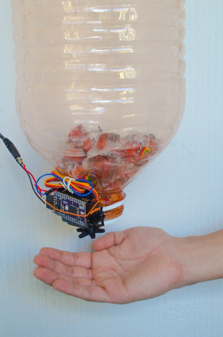

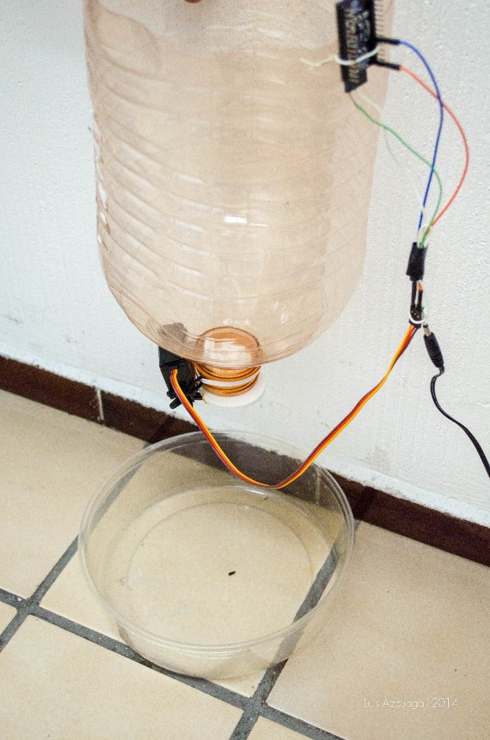

The material used for this tutorial was:
- 2 Altair
- 1 Servomotor
- 2 Clamps
- 1 Empty water bottle
- 1 Cutter
Of course you can make your own design, I made it with materials I found in my house.
The other Altair will be used as the Hub, so we can interact with the Feeder via Internet.
Additionally, I used a 5V and 500mA AC Adapter plugged into the Altair
