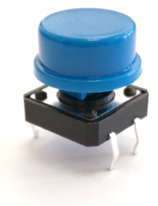

- 2X button

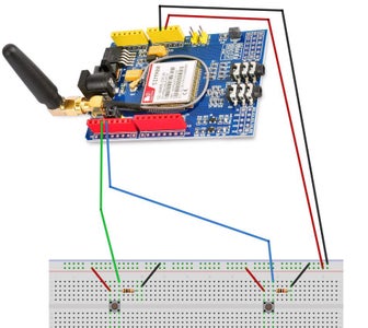

Step 2: The Circuit

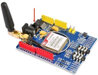

- Connect the SIM900 GSM Shield to the Arduino
- Connect Arduino pin [5V] to breadboard positive pin [Red line]
- Connect Arduino pin [GND] to breadboard negative pin [Black line]
- Connect Arduino Digital pin [2] to button1 on the breadboard and to the Resistor1
- Connect other side of the resistor1 to the breadboard pin [GND]
- Connect Other pin of the button1 to the breadboard positive pin [5V]

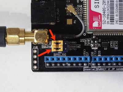

- Connect with the Jumpers on the shield pins D8(RX) & D7(TX) like you see it on the picture

- Connect the 5V Power Supply to the shield, and set the switch on the shield to the External Power (See the picture)
- Once the Power is connected hold the Power button for 2s
- Once the connection with the Network is established the LED will blink every 3s

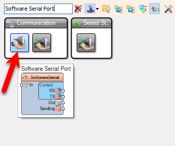

- Add "Software Serial Port" component

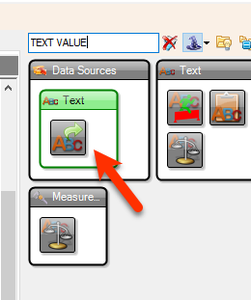

- Add "Add "Text Value" component
- Add 2X "Debounce Button" component

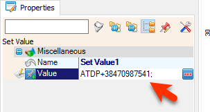

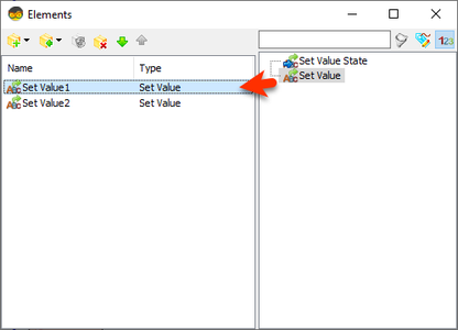

- Double click on the "TextValue1" and in the Elements window drag "Set Value" to the left side and in the properties window set "Value" to ATDP+ PHONE_NUMBER (International Format) & add semicolon at the end
Example: ATDP+38470987541;
- In the Elements window Drag another "Set Value" to the left side and in the properties window set "Value" to ATH
Example: ATH
- Close the Elements window
