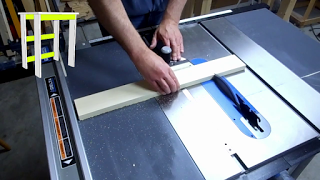

Step 1: Cut the Legs and Cross Pieces
- Rip the stock for the legs and cross pieces to 2 1/2 inches.
- Cut 4 legs to a length of 24 3/4 inches.
- Cut 6 short cross pieces to a length of 8 inches.
- Cut 4 long cross pieces to a length of 18 1/2 inches.
- Rip stock for 2 narrow cross pieces to 1 1/4 inches.
- Cut those to 18 1/2 inches long.

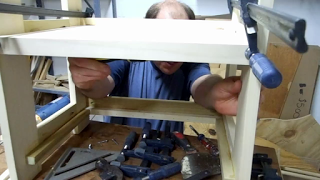

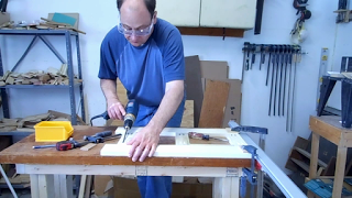

Step 2: Pocket Hole Assembly

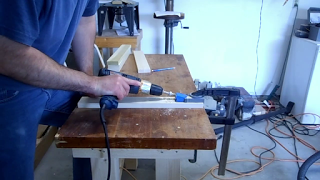

- Drill two pocket holes in each end of the wide cross pieces.
- Drill one pocket hole in each end of the narrow cross pieces.
- Attach a wide short cross piece to the top of 2 legs.
- Attach another wide short cross piece 12 1/4 inches from the bottom of the 2 legs.
- Attach another wide short cross piece 2 inches from the bottom of the 2 legs.
- Repeat for the other side.
- Connect the 2 sides with 2 long wide cross pieces at the top.
- Connect in the back with the other 2 long cross pieces at 12 1/4 and 2 inches from the bottom.

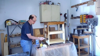

Step 4: Cut and Install Shelves
- Cut the 2 lower shelves out of the plywood to 18 1/2 to 13 1/2 inches (check and cut to size if needed)
- Attach the narrow cross pieces and then the other long cleats.
- Glue the 2 lower shelves onto the cleats.
- Cut the top shelf to 20 by 15 inches.
- Glue the top onto the unit.
- Glue the longest trim piece to the front on the top.
- Glue the shorter trim pieces to the sides.
- Glue the last trim piece to the back.

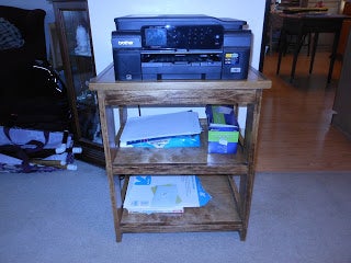

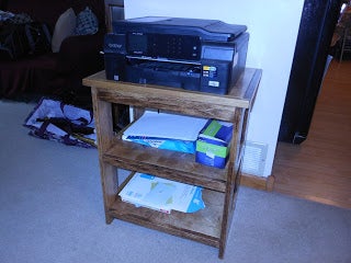

Step 5: Finish
- Sand to 220 grit.
- Apply wood conditioner (if using a wood prone to blotching) and stain.
- After that dries, apply a top coat such as lacquer or polyurethane.
