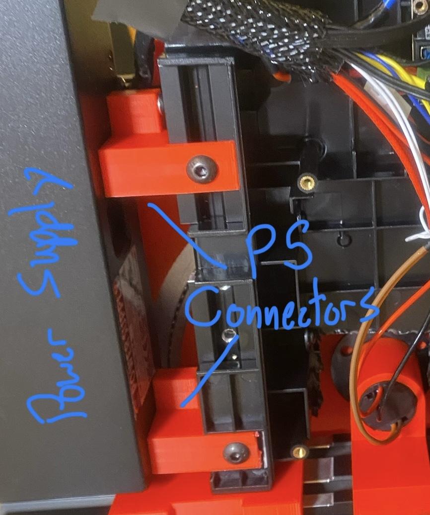

If you use the Ender 2 power supply, you'll need 2x M4 bolts to mount the Ender 2 PS Connector parts to the power supply. Unfortunately, I don't remember what length they were. Just a heads up...

If you're using the Ender 2 power supply: 2x Ender 2 PS Connector

If you're using the Ender 2 power supply, it will need to be rotated 180 degrees so the power switch and plug are accessible (see picture). Disconnect the power wires from the main board. The third ground wire isn't long enough, so you'll have to cut it. Then mount the power supply to the aluminum extrusion in the base using two Ender 2 PS Connector parts. You'll need 2x M5x8mm bolts from the Aluminum Extrusion Corner Bracket Kit and supporting T nuts to mount the prints to the underside of the aluminum extrusion (see picture). You'll also need 2x M4 bolts to mount the prints to the power supply. I don't remember the length. Just make sure the length isn't long enough to where the bolt is hitting any of the internal components of the power supply!
If you're using the Ender 3 power supply, just remove the Ender 2 power supply.
