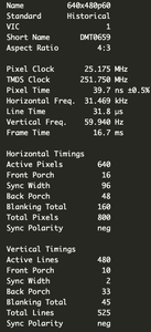

display_timings_480p.sv, generate the VGA timing as the picture 4 and 5.
