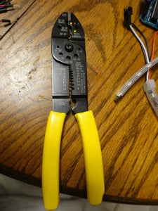

  6. Wire strippers

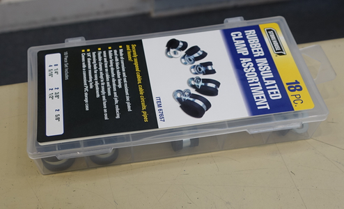

  7. Rubber insulated clamp
