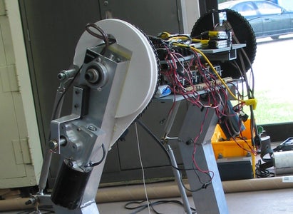

Step 1: Full Scale Prototype

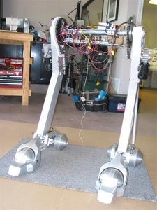

While the Art department was making final refinements to the design we spent a couple of days making a full scale working prototype.
We started by drawing up some parts on the computer and cutting them out, while at the same time looking at various motors, gears, servos available to make this thing move. To have the tork we wanted to drive the hips and wheels we decided to use windshield wiper motors that we drove with custom made control boards and a potentiometer connected to the drive shaft to turn it into a big servo. We took off the cast gear box and machined our own to allow us to design our own mounting face as well.
For our first test we wired everything into a plugged in power supply, later that would need to be changed for something self contained.

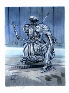

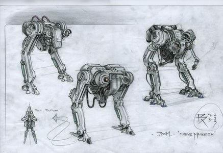

Step 2: Concept Art
For this build concept art was provided by the films art department. A number of renderings and concept sketches by Bartol Rendulic came our way and finally he provided us with projected view drawings for this robot. I say finally not to sound like it took a long time, Bart draws like a maniac and we were getting updated and revised drawing every day or two.
Notice here the robot was named Steve Maqueen at this point of the project

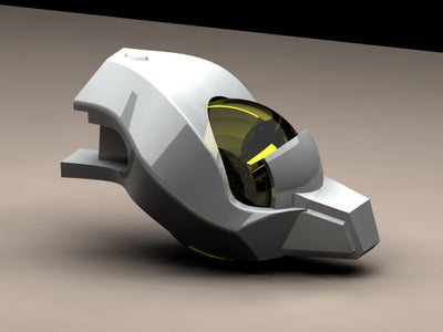

Step 3: 3D CAD Modeling and Renderings
Now that we received approved drawing with projected views we were able to bring those sketches into Solidworks, resize it to the correct scale and begin using that as a guide to model the parts.
I have made the drawing available to download so you can view it as an edrawing. If you don’t have an edrawing viewer, get one here for free.
The CAD data served us in many ways. First off screen shots and renderings could be sent to the art department for approval, but more importantly for us it allowed us to build accurate parts that looked almost exactly like the drawing and rendering we were sending to the client.
Once we had a few key components modeled up and approved we started making them. A 3 axis CNC mill did a lot of the work for us. Some of the frame work for the body required only 2D cutting so for those aluminum plate was cut using a CNC water jet cutter.

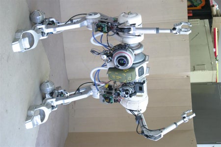

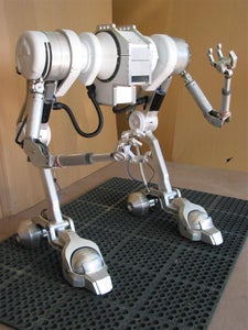

Step 6: Bringing It All Together
At this point all of the electronic and mechanic have been mostly sorted. All that is left is a little fine tuning. This stage really comes down to final assembly and dressing the puppet up with mostly non fictional detail. Here we are adding parts that have been purchased from a variety of sources, hardware stores, automotive, medical, industrial suppliers. For this style of build it is important to included parts that look familiar, defiantly earth based, NASA surplus looking mechanics. One thing I try to do is to not use obvious bits of hardware that the view can pick out, and if I have to, I try to us it out of context to help hide it.

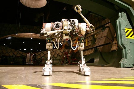

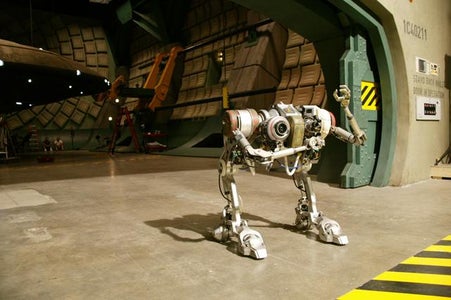

Step 7: On Set
Here it is on set. At times it took two operators to bring this to life. One to operate the legs on 4 channels to make it walk, turn and pitch forward and back, while another person would control the arms at the shoulder, elbow and wrist which used 6 channels.
So that's that. Make a robot puppet in under 4 weeks.
It was fun to make, don't remember seeing the movie though.
