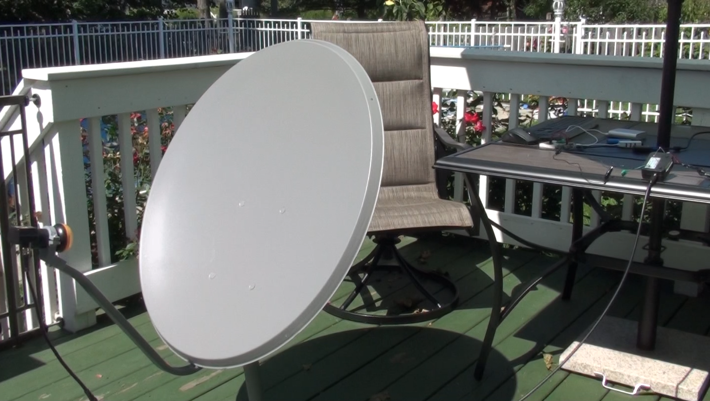

It is really easy to get an optical telescope. You can just buy one from a manufacturer of such telescopes. However, the same cannot really be said of radio telescopes. Usually, you have to make them yourself. In this Instructable, I will show how to build a radio telescope that scans the sky within the frequencies of 10.2 GHz and 12.75 GHz.

In order to test the Radio telescope, point the dish at such as the sun, the strongest emitter of radio waves from our perspective on Earth. In order to do so, point the dish towards the sun so that the top of the shadow of the LNB hits where the LNB arm meets the dish. Now, turn your Raspberry Pi on and run toScreen.py, the Python script for reading results from the ADS1115 and printing them on screen. You can run this in either the Python 3 IDLE, or terminal. Either way, you should get a prompt asking for the gain, followed by the sample rate, and how long you want the Pi to read the ADS1115’s output. With your dish pointed at the sun, run the script for about 10 seconds. If very low numbers initially shows up, turn the gain knob on the Finder up, very slowly. The numbers should increase until it reaches about 30700. By then, you can stop turning the knob.
