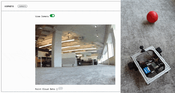

From exploring dangerous environments to picking up litter, you can do so many things with a wheeled robot and computer vision. This tutorial is a great starting place for a wide variety of robotics projects.
In this tutorial, you’ll learn how to make a rover follow a colored object using the Viam vision service. I used a SCUTTLE rover with a Raspberry Pi 4, but you can use any rover with a webcam.

Step 6: Run the Code
Now, run the code again, from the same directory as your main.py file:
python3 main.py
Your rover should detect and navigate towards any red objects that come into view of its camera. Use something like a red sports ball or book cover as a target to follow to test your rover.
Step 7: Next Steps and Full Code
Congratulations! You now have a robot that can follow colored objects!
