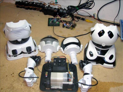

Step 1: Get the Hardware
I always hook up the hardware to the circuit board to verify it works before i build a robot. In this step, i connect the servos to the board, and simply make them move.
Yay it works!

Step 3: Take Apart Your Robot Shell

Step 6: Assemble the Robot
