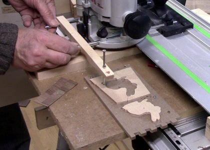

Make a little arm as a follower and stick it on the router. The pin should have the same diameter as your router bit.
Put the router on his rail, mount your work piece and your template on the board and start copying.

Glue both parts on a little board and mount it on the board of your copy carver.
Step 5: Carve the Negative

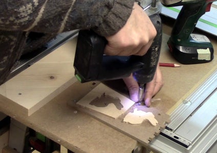

Mount your work piece on the base board . Make sure the distance is the same as the distance from the router bit and the follower pin.
In a first step I use a 6 mm router bit, to remove all the wood in the middle of the template. I this case my follower pin has also 6 mm. In a second step I change it to a 3 mm router bit and the follower pin also to 3 mm to carve all the small corners and edges.
My 6 mm pin is a little tube and in the middle is the 3 mm pin.

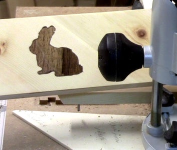

Step 6: Carve the Veneer
To hold the veneer save in place I glue it with hot glue on a support board. Later you can separate it very easy with alcohol.
To carve it I use the 3 mm router bit.

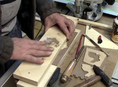

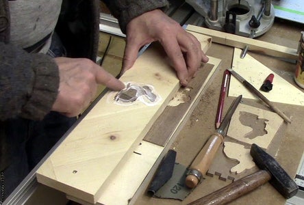

I glue the veneer in the board, and filled little gaps with wood glue and saw dust.
After sanding I put a layer of linseed oil on it.
