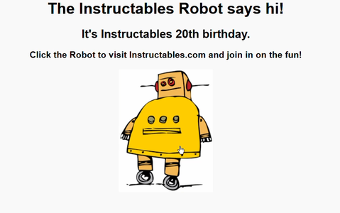

In the end, you'll have a device that, when plugged into a Windows device, can display the Instructable robot's face within about 15 seconds! Please note that although this Instructable is targeted at those using the Windows operating systems, the programs can be changed for use with Linux and other OSes.

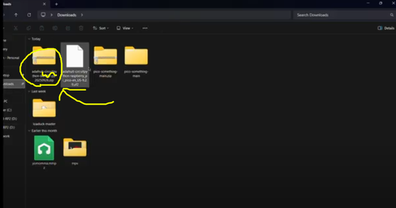

  1. Visit https://circuitpython.org/downloads and click on your Pico board
  2. Press the 'download UF2 button'. Wait for the download to complete.
  3. Press the BOOTSEL button on the Pico down, and at the same time, connect the Pico to your computer with the USB data cable
  4. There will be a pop-up about a drive being connected, 'RPI-RP2'. Go to File Manager, and drag and drop the UF2 file you downloaded straight into the 'RPI-RP2' drive.
  5. The drive will disconnect, and then a new drive will appear in a few seconds named 'CIRCUITPYTHON'

  1. Click on this link to download the full CircuitPython library bundle https://github.com/adafruit/Adafruit_CircuitPython_Bundle/releases/download/20250926/adafruit-circuitpython-bundle-py-20250926.zip

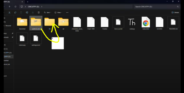

  2. Unzip the CircuitPython bundle, and navigate through the folders until you find a folder labeled 'lib'.
  3. Enter the lib folder, and search for 'adafruit_hid'
  4. Copy the 'adafruit_hid' folder into the CIRCUITPYTHON drive
  5. Enter the CIRCUITPYTHON drive, and copy the 'adafruit_hid' folder into 'lib'
So now the 'adafruit_hid' folder should be at this location: 'D:\lib\adafruit_hid'.

Now you can sneak up to a busily browsing friend, plug this into their computer, and wait for the robot to pop up! Hopefully now you understand the power of even simple USB devices and better comprehend the varied dangers we face in this information age.
