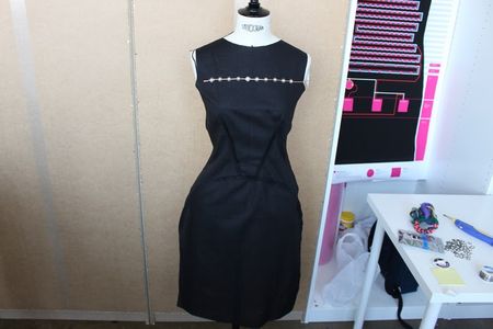

Step 7: Making the Textile Shield
The shield is a textile piece cut from cotton muslin that houses all of the electronics to go inside of the final dress! We made this system modular so that Zac's team could work on the "body" of the dress while we worked on the "brains". The night before the show, the shield was sewn into the exterior of the dress.
To make the textile shield, you cut out the upper bodice of a pattern just like if you were to make a garment.
SEAM ALLOWANCE
For the shield, it's recommended to leave extra seam allowance. Electronics add a bit of bulk and there's nothing like sewing in all of your wires to realize that something isn't long/ wide enough!
CUTTING
Cut out enough to make two versions of the garment's lining (this is what you'll use to make the shield). You'll contain electronics inside of these two versions, just like if you were to create a pillowcase.
SEWING
You'll want to first sew together the lower and upper shield so that you have two pieces. Once you start adding electronics, it's tricky to machine sew, so do your side seams, darts and neckline before attaching electronics. We sewed pockets and a flora UI pad into the shield to make it easy to use. Take freedom with your pattern and layout!
