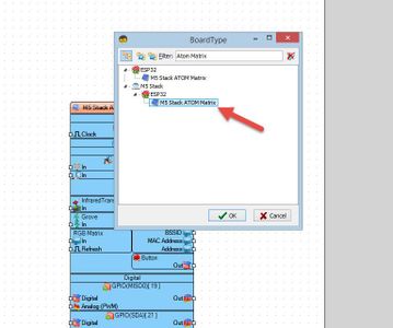

Step 2: Start Visuino, and Select the Atom Matrix Board Type

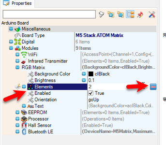

Start Visuino as shown in the first picture Click on the "Tools" button on the Arduino component (Picture 1) in Visuino When the dialog appears, select "Atom Matrix" as shown on Picture 2

  • Select "M5 Stack ATOM Matrix" board and in the properties window expand "Modules">"RGB Matrix">"Elements" and click on the 3 dots button

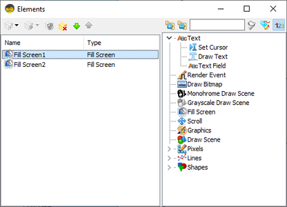

  • In the "Elements" window drag "Fill Screen" to the left side and in the properties window set "Color" to aclRed
  • In the "Elements" window drag another "Fill Screen" to the left side
  • Close the "Elements" window

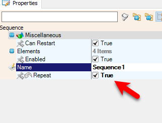

  • Select "Sequence1" and in the properties window set "Repeat" to True

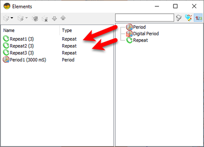

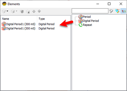

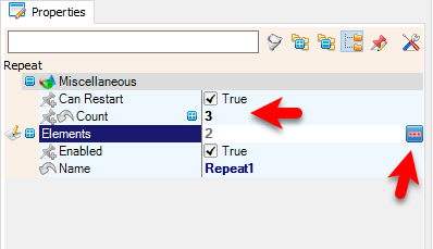

  • Double click on the "Sequence1" and in the "Elements" window drag "Repeat" to the left side and in the Properties window set "Count" to 3 and select "Elements" and click on the 3 dots button
  • In the New "Elements" window drag "Digital Period" to the Left side and in the properties window set "Delay" to 300
  • Drag another "Digital Period" to the Left side and in the properties window set "Delay" to 300
  • in the "Elements" window drag another "Repeat" to the left side and in the Properties window set "Count" to 3 and select "Elements" and click on the 3 dots button
  • in the "Elements" window drag another "Period" to the left side and in the Properties window set "Delay" to 3000
