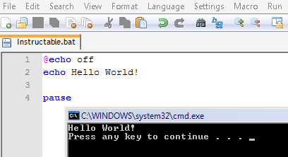

Ok so it does help to know some batch file basics. Right now I will explain what I can.

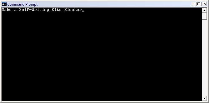

@echo off - this will make it so that when you open up the batch file, it wont show the commands
echo - any text following this will be shown on the Command Prompt window
ex. echo Hello World (see pic)
Pause - causes the batch file to stop. Displays "Press any key to continue..."
echo. - creates a blank line

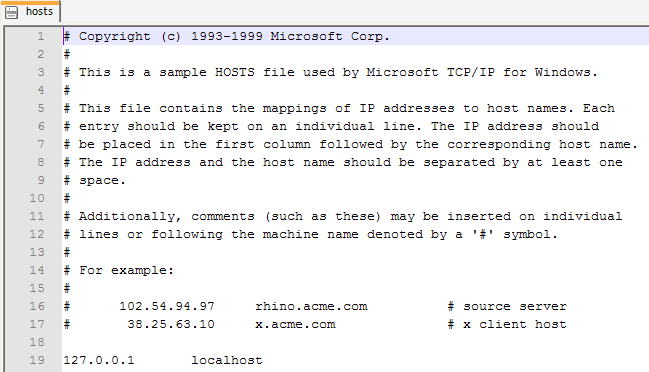

Step 2: Hosts File Basics
Ok. Before moving on, I suggest you look at your hosts file.
This is generally located in C:\WINDOWS\SYSTEM32\DRIVERS\ETC
You will have to open it with a text editing program, preferably notepad. Once you've done this you can take a look at it and see how to use it.
The big box below is how windows tries to explain how this file works. To make it simple, find an IP address for another site and then type the site you want to redirect from. To block sites just use 0.0.0.0 and then type the site you want to block next to it.
ex. 0.0.0.0 google.com
This tells your computer to send google.com to 0.0.0.0 which then says that it can't connect.
