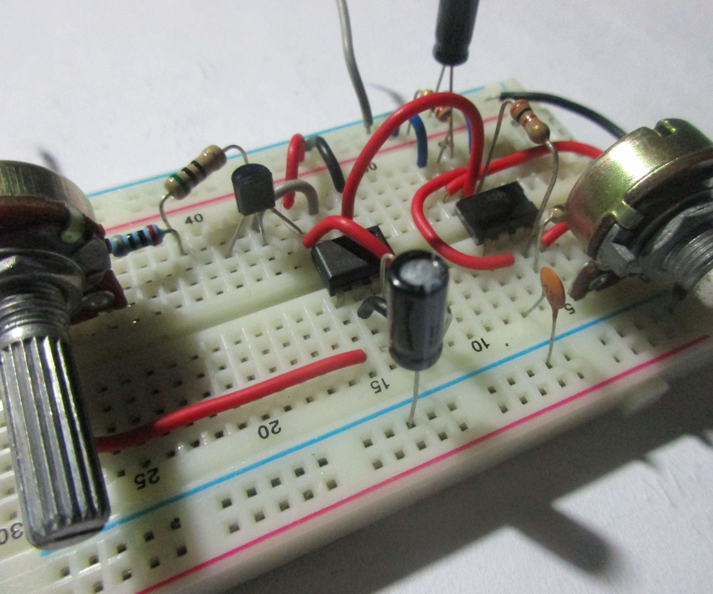

Construct the circuit as shown in the design(or in your modified design). A breaboard is essential if you want to test it first and later, solder it in a small pcb if you like.
Step 4: Testing the Circuit
Here I am using an old set of 1.5V batteries cells, 6 all in all to form a 9V battery.
Measured parameters are shown in the image above.
