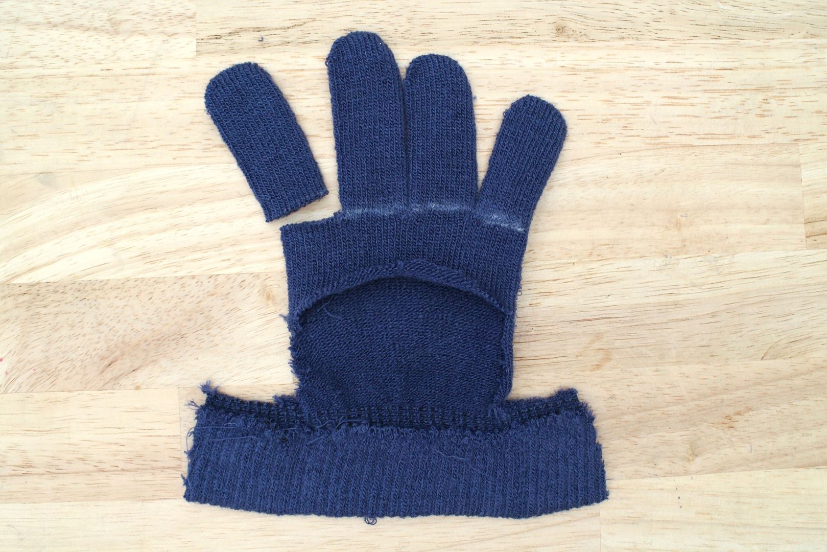

Step 3: Measure
For this simple pattern, it's ok to draw straight onto the fabric. You are welcome to make a paper pattern for future use.
First, grab the soft measuring tape and take some measurements. Write down the measurements from the three places illustrated above.
1) Across the knuckles
2) Length of back of hand from knuckles to wrist
3) Circumference of wrist

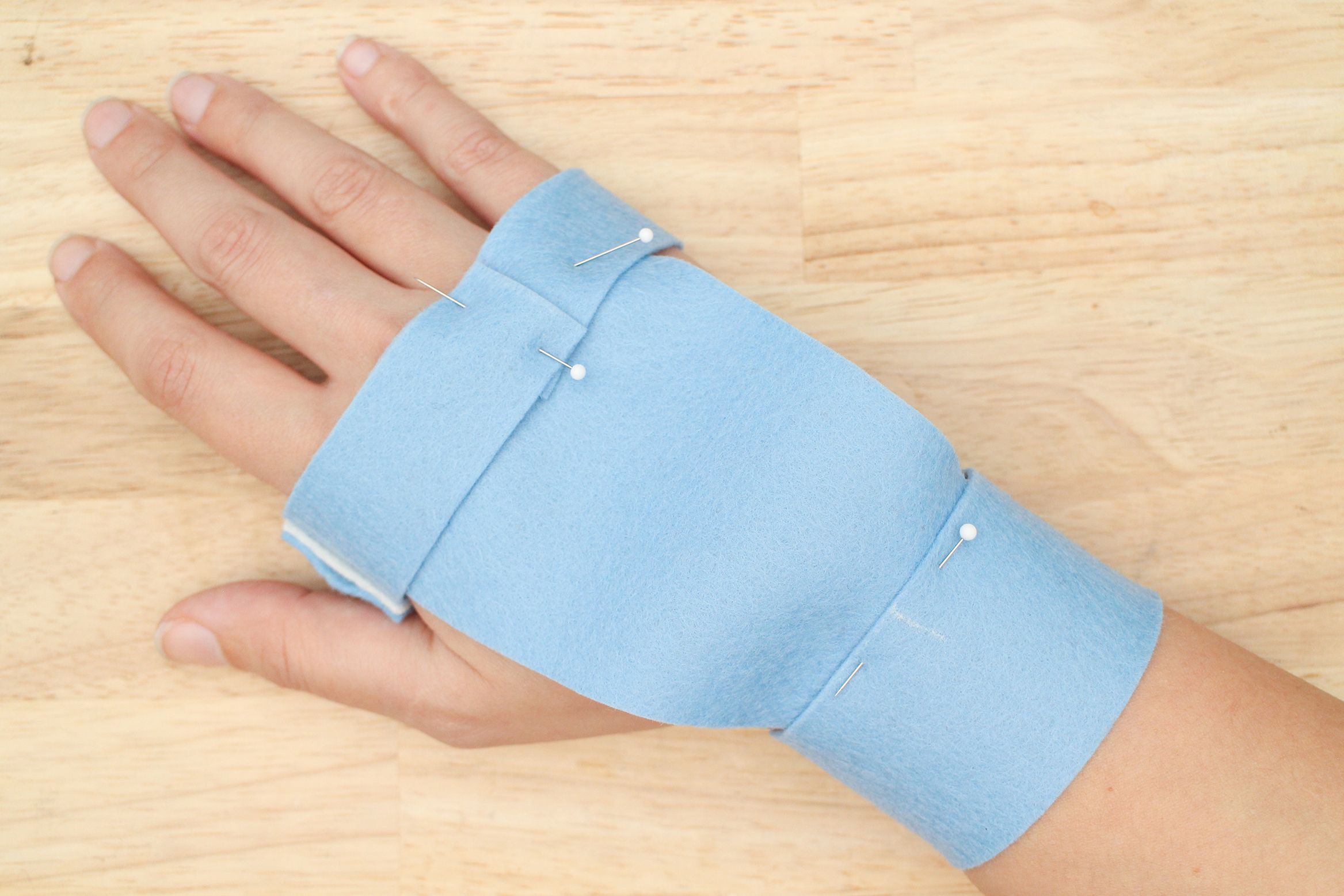

Step 5: Cut and Pin Together

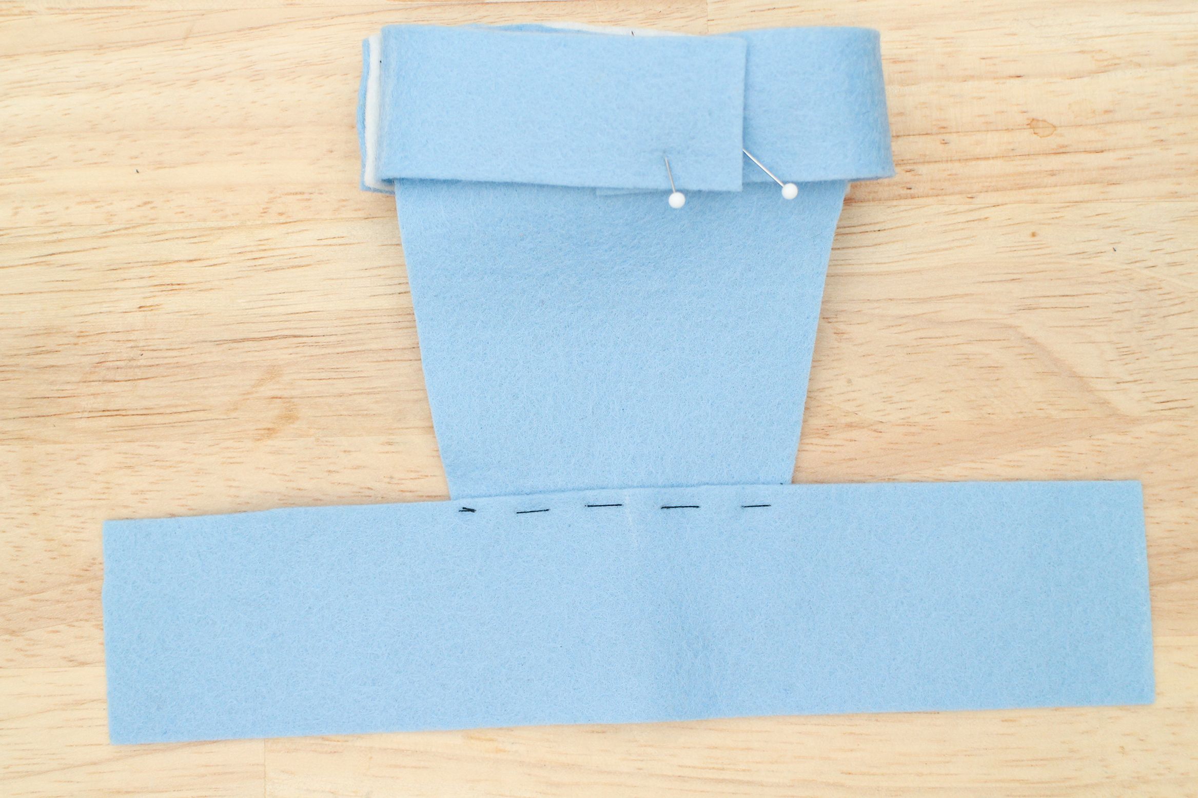

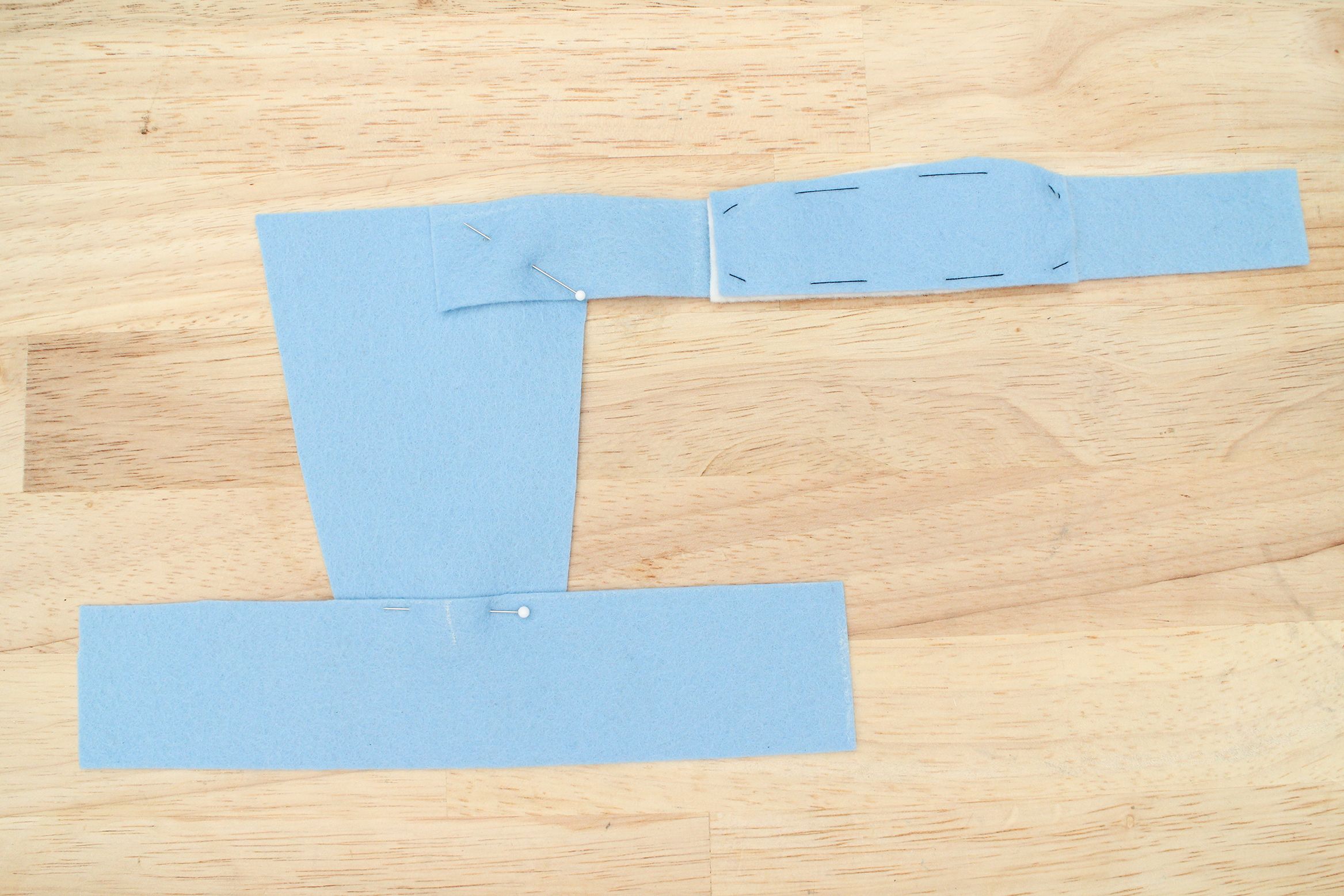

Cut out both the back of the hand and the wrist strap patterns. Pin them together and place over the hand to get a feel for how the pieces size up. The top of the trapezoid should cover your knuckles and the wrist strap should comfortably be able to wrap around your wrist. If the pieces are too large, trim them back. If they end up being a little too small, it's best to cut them out again with added length.
Pin the switch to the top of the trapezoid, leaving one side loose.

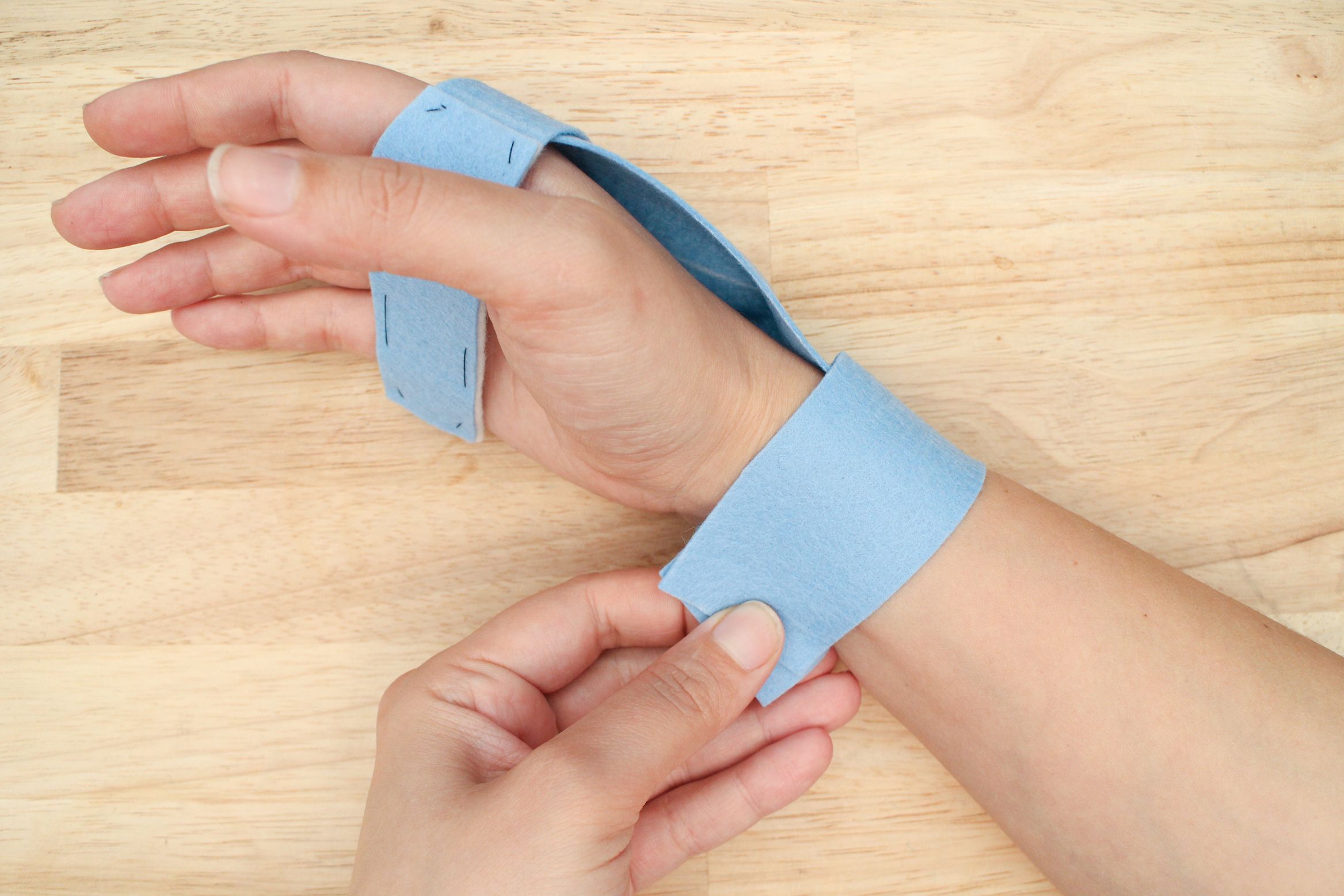

Time to try it on! Pin the switch strap around your hand and the bottom strap around your wrist.

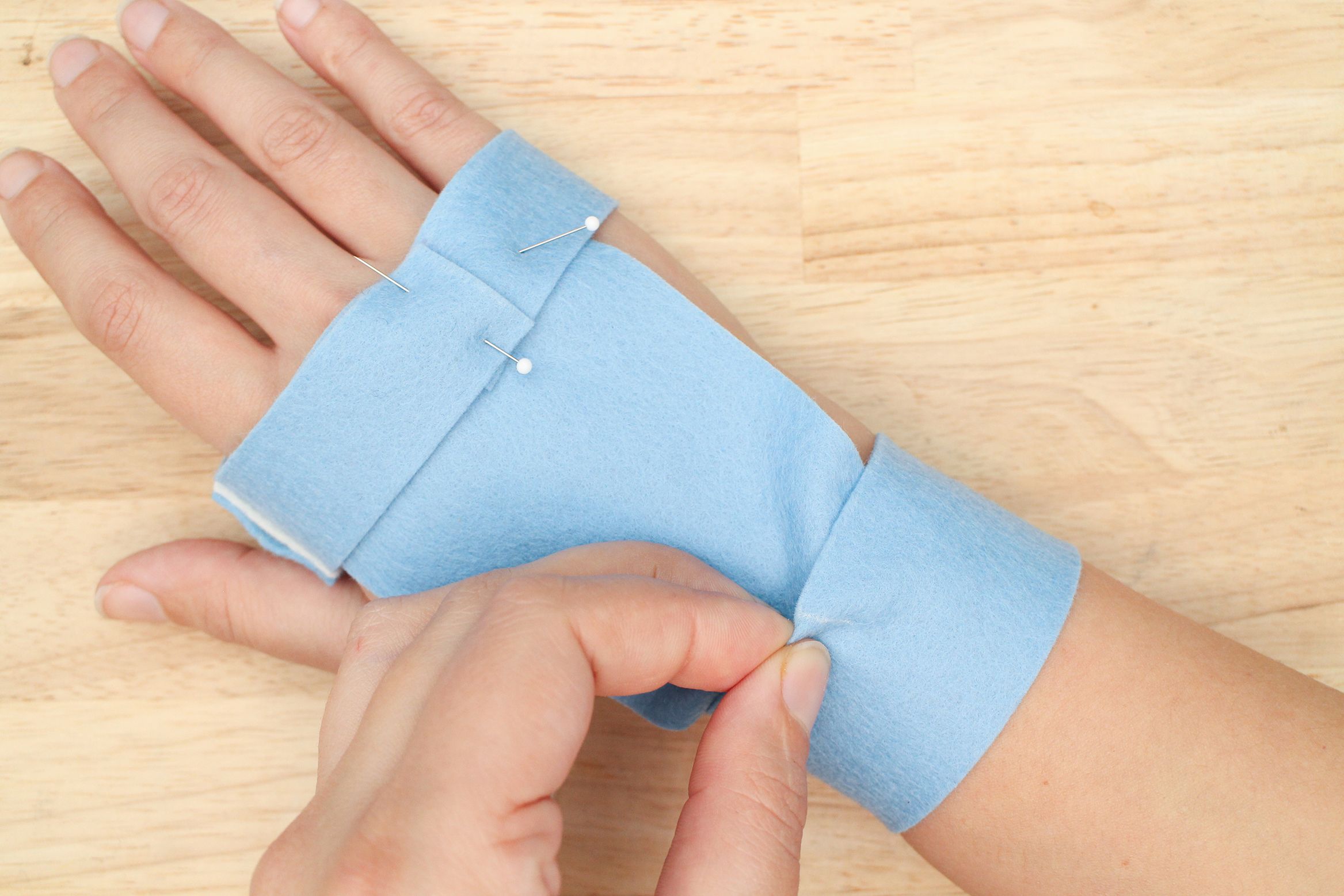

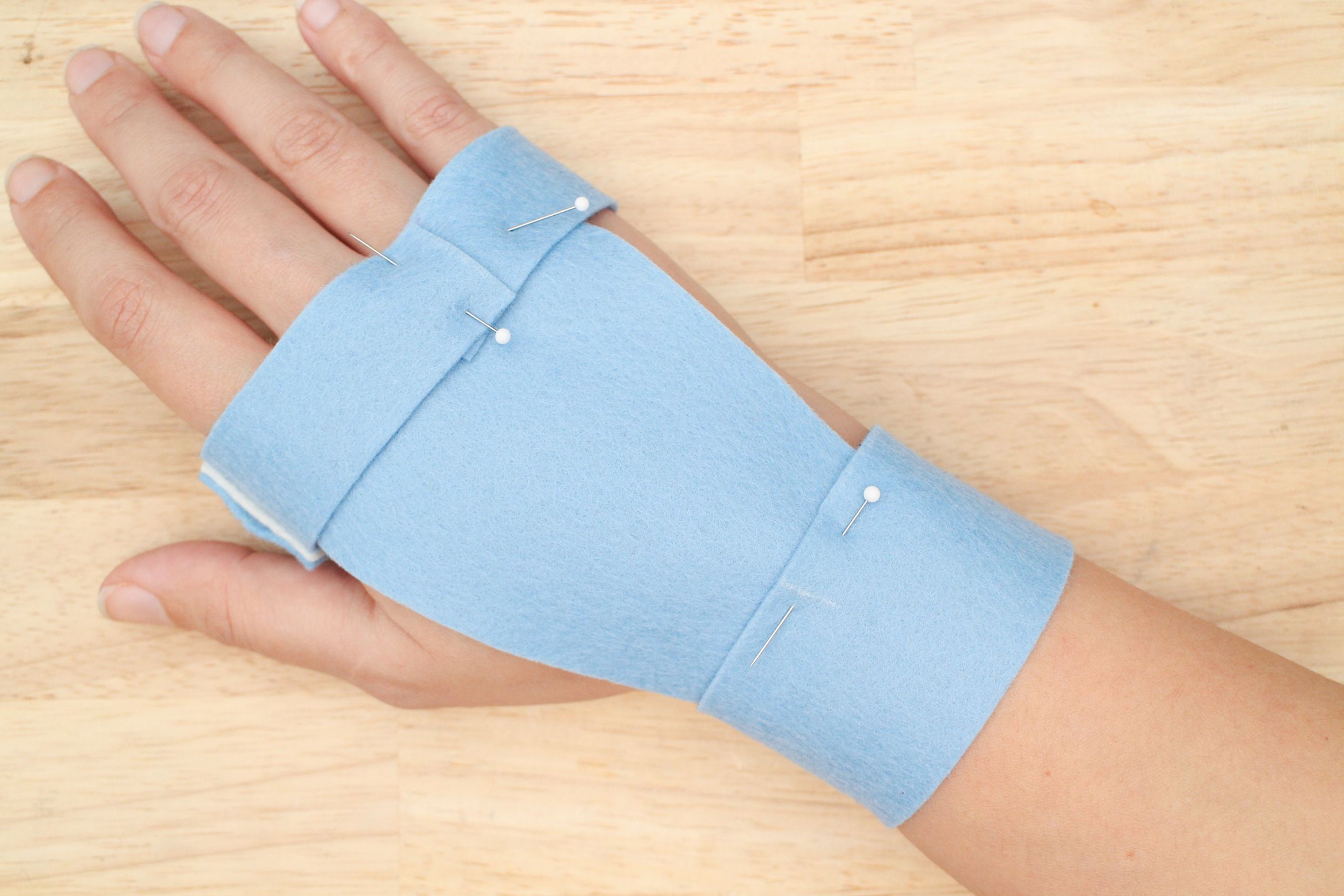

Step 6: Fit
The only strap that you need to make adjustable is the wrist one. This means you need to fit the switch on snugly because you won't be able to adjust it later.
Test the switch with the multimeter on the continuity setting as it's pinned to get the right fit.
Once it's pinned, you will most likely see some bulges or buckling of fabric. If this occurs, unpin, tuck in extra fabric and pin in place. If working one handed proves to be difficult grab a friend to help you.
Step 7: Sew

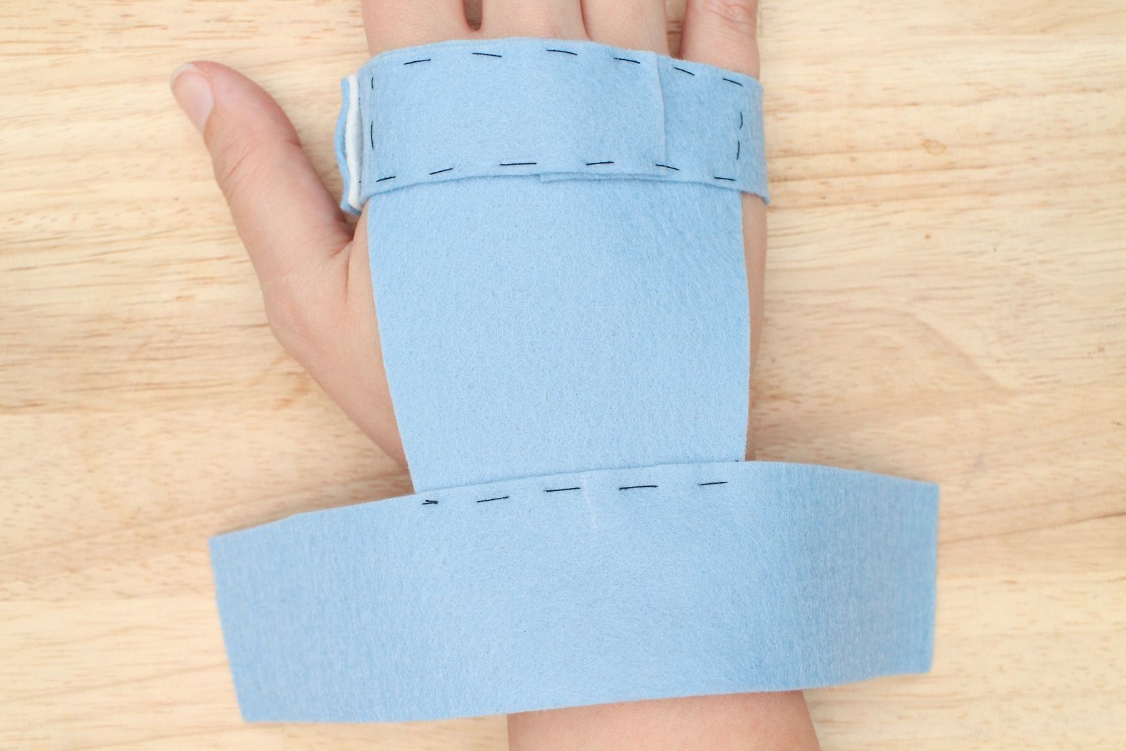

Grab a needle and thread because you are ready to sew your connections. Use a basting stitch to join the trapezoid and wrist strap.
Stitch the switch strap in place. Great job! You have created and fitted a custom pattern! Try it on one last time, is the switch strap too loose? Is it too snug? How is the length of the trapezoid? Test the switch with the multimeter again to hear it beep while closed.
