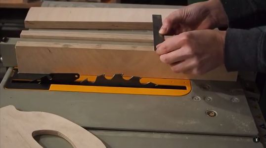

Step 1: Make a Box for Your Fence
The jig starts by making a box that will slide snugly on your table saw's fence. I started by measuring the height of my fence. I however noted that the top of the fence had some screws protruding, so I made sure to consider those in my measurements. I cut 2 strips of scrap 3/4 birch plywood to that height, about 10 inches long.
I placed the freshly cut plywood strips on each side of the fence, then measured the total width. I then cut a third strip of birch plywood to this width.
Lastly I glued and screwed the pieces together, making sure the box would slide freely back & forth on the fence while being snug.

    You might also want to make the splines before cutting the frames. With your setup, the cut is as thick as the blade in use. You might want to look at a dado blade or a full kerf sawblade and think of how to cut the slots to fit your splines.

    Fence issue: You may want to adhere a piece of material (wood, plastic laminate, etc.) to each side of your fence (or just to the left side) so the face of the fence is a consistent thickness. You might be able to use a clamp to squeeze the front edge a bit to remove the 'bulge.'
