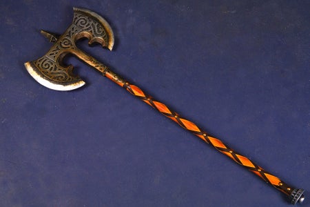

The filigree is in two distinct sets. The lower section on the blade sides and a raised centre section. Start by carefully cutting out the blade sections from the template. Once that is done, offer the template up to the head to check the fit. If you are happy, transfer the template to your funky foam and cut two of the pattern out. Using impact adhesive add the two patterns to either side of the blade as in the second image.
At this stage I added the two little lower plates on the base of the blade and made the centre spike by laminating two pieces of tile and carving it out with scalpel and Dremel. These were all glued in place.
Go back to your template and cut out the centre section and the filigree on that. Offer up and when happy cut two patterns and add these to the blade sides.

I was stuck with the handle length I had, the piece of wood was exactly 3 feet long. I marked off 28 mm at the base of the handle (two thicknesses of tile for the pommel), then measured from that line to the base of the 'metalwork' on the head (60 cms). Now, on the original image the axe only uses two strips of leather, but in order to make my handle a little more 'chuncky' I decided to use 4.
I cut 4 strips 1 cm wide and 3 feet six inches long.
On each side of the handle I marked a dot every 10 cms. The first two strips were given a dab of glue and stuck over each other at the dot nearest the base. This is just to hold them in place. I then wrapped them and nailed them at alternate dots on the handle, turned it over and did the same for the second pair of strips. The ends were trimmed with a scalpel. Then a securing ring of faux leather 2 cms wide was wrapped around the top, two small leather sections added at the base and nail in place. Lovely!

In order to tone down the handle I gave it a light over spray with some burnt umber acrylic paint. I then gave the entire weapon two coats of matt lacquer spray to seal it and tone it down a little more.
The base pommel is made from three disks of tile. The first two have a centre hole to accept the handle. I roughed all these out using some hole saws which make light work of the job. The three diskes were laminated together using impact adhesive and then shaped off with the Dremel. I put some random engraving marks on with a soldering iron then painted them using the same techniques as the blade head.
The pommel was glued into place on the end of the handle.
Step 7: Completion
This little project took me a couple of days to complete, mostly waiting for glue and paint to cure. I looks and feel sunstantial enough and I was pleased with the outcome.
