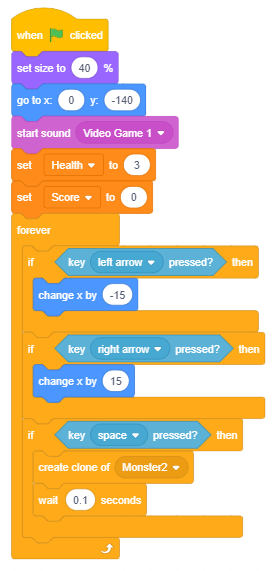

Step 4: Writing the Script for the Rocketship
To write the script for our Rocketship first select it from the Sprite Pallete.
Set x as 0 and y as -140 into the x () y () block; these coordinates will be our rocketship’s initial position.
Change the rocket's size to 40% of the original size.
The Health variable will monitor the health of our rocket ship and the Score variable will keep track of how many enemies we have killed.
Set the Initial value of health to 3 and Score to 0 using the set variable to () block.
We’re going to control the movement of our Rocketship using Dabble’s Gamepad module. The following actions will be triggered.
- On pressing Left, the value of x coordinate will change by -15 i.e our Rocketship will move 15 steps in the left.
- On pressing Right on the gamepad, the value of x coordinate will change by 15 and the rocket will go right.
- On pressing Triangle button on the gamepad, the bullets should start firing.
Note: To make the bullets fire each time we press the triangle, thus use the clone block.
Write the following script:

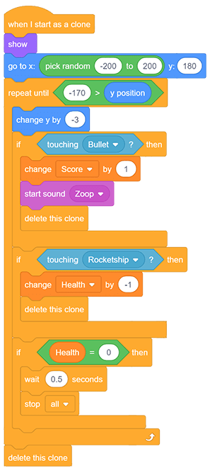

Step 6: The Health and the Score
The health of the rocketship and our score completely depends on the monster. We are going to write the script for the following possible case:
- As soon as a monster is hit by a bullet, the score should increase by 1 and the monster should disappear.
- If a monster touches our Rocketship, its health will decrease by 1 and the monster should disappear.
- Also, the game should end as soon as Health goes down to zero.
The following script functions for the points above.

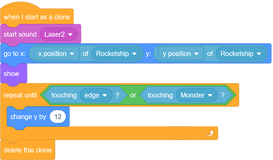

Step 7: Script for the Bullet
It's time to write the script for the monster-killing bullet.
Thus, select the Bullet Sprite from the Sprite palette.
- The initial position of the bullet same as that of the rocketship so that it appears that the ship is firing the bullets.
- Also, the bullet should disappear as soon as it touches the monster or the edge.
Write the following script for the same:
