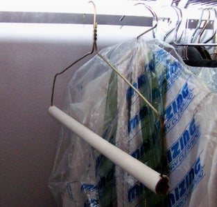

My wife has one of these hangers left. A friend informed me it is called a drapery hanger. This past Sunday I had to use it to hold up the lower third of my clergy gown so I could transport it to a church where I would have the sermon. My wife informed me I had most certainly better not forget and lose this hanger! I did not forget. And, I decided to make a copy better than the original so we would have a backup.
Step 1: Materials and Tools
The photo shows the original hanger with a cardboard roller across the bottom. At the top of the photo is a dowel rod about 3/4 inch in diameter. The cardboard roll on the original is a little larger in diameter, but this is what I had. Also pictured is some steel rod about 1/8 inch in diameter. It is from a folding tripod floral stand like those used at funerals. I officiated at a funeral and no one wanted the floral stand afterward. The funeral director said it was fine for me to take it for my welding projects. The steel has some bends in it that will need to be straightened.

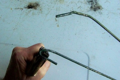

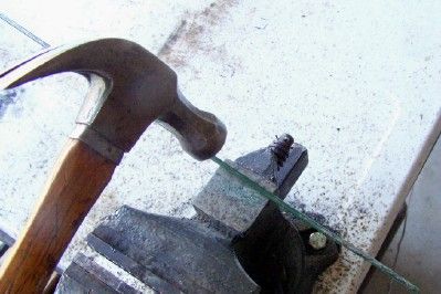

Some preliminary straightening can be done with a Vise-Grip pliers. Then pound the steel flat on an anvil or the flat area on a vise. Twist the rod as it is pounded and most of the bends will disappear completely. See the second photo. Grind a rounded end on one end of the steel rod.

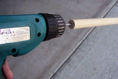

The standard width of a clothes hanger is 18 inches. Cut the dowel for this width. Locate the center of each end. Drill into the center of the dowel about 1 1/2 inches from each end with a bit the size of the steel rod.

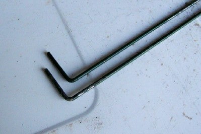

Measure in 1 1/2 inches from the blunt end of each piece of rod and make a 90 degree bend.

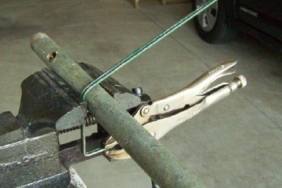

The finished hanger should have symmetrical bends. I ganged the two pieces of rod together with a Vise-Grip pliers. Then I measured 2 1/2 inches from the 90 degree bend and clamped the two pieces in a vise with a piece of pipe. The pipe will form the gentle radius in the second bend. This will closely approximate the profile of the original hanger.

I added another bend in the neck of the hanger just below the hook loop held by my finger. This is for the purpose of finding the point at which the bottom of the hanger hangs as close to level as possible. This is a good sturdy hanger, and my wife is impressed. She likes it.
We probably could have waited until the next time my wife sends drapes to the dry cleaner to get another hanger. I am not sure either of us remembered where we got the original hanger. At least now we have a second hanger.
