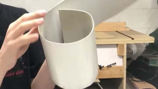

The tube's height is 5.5" because that's the height of the scrap I had. It's 13" long which is as short as you can make it and still have room for the foam and can.
Once it was cut to size with the cut off wheel, I used a spray can and a quart paint can to curve the sheet metal. The spray can helps to start the curve, while the larger can helps maintain the desired radius.
I clamped the ends of the tube with a .5" overlap. I drilled (3) 3/16" holes along the seam, then installed the 3/16" pop rivets with a riveter. I used a punch on the holes before drilling to prevent the drill from walking.

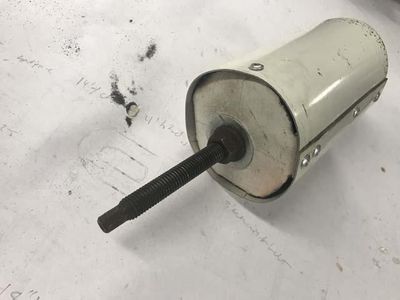

The tube isn't perfectly round, which is okay. I traced the opening onto the sheet metal. I then sketched 4 tabs around the base, .5" square in shape. I clamped the metal to my work bench and cut the base out with a cut off wheel as close to my sketch as possible. I used a vice to bend the tabs up, making sure the bend was inside my sketch line so the base would fit inside the tube.
The base is a tight fit in the tube which is good. I drilled through the tube and each tab and installed 3/16" pop rivets. I punched the holes first. I then drilled a 1/2" hole for the bolt. I made it slightly off center for centripetal motion. I feel like that will mix the paint better, but it's just a guess.
I placed a fender washer on each side of the base with the through bolt and nut.

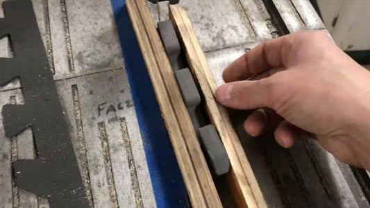

I used the interlocking edge of a foam floor mat. It's cut to about 12" long. I had to cut it on a band saw vertically to make it thinner so it and the can fit in the tube. To cut it on the band saw, I sandwiched the foam between two pieces of plywood to keep my fingers safe. I applied contact cement to the back of the foam and to the inside of the tube, let it dry for just a couple minutes so it was still wet and allowed for working time. I positioned the foam at the top of the tube.

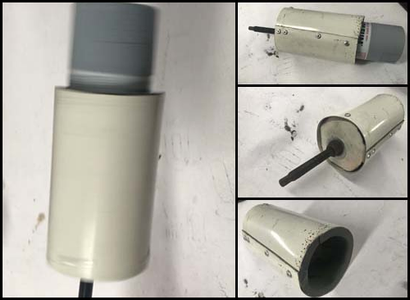

I filed all the metal edges so they wouldn't be sharp. I like the frame bolt as the end is a hex shape which fits in the drill well, but a regular bolt would provide enough grip. This works exactly as intended, and it requires a lot less effort than shaking by hand. I'm sure thirty seconds of using this mixer is better than two minutes of hand shaking.
