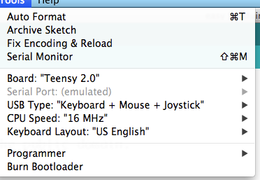

Open the Arduino IDE, plug in the Teensy, and upload the sketch.  You'll need to select Keyboard+Mouse+Joystick as shown below for USB type.  Press the reset button on the Teensy and it should upload.

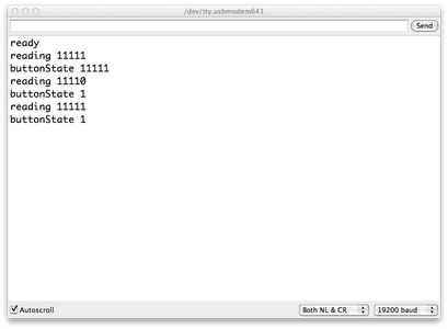

Open the Serial Monitor, you should see diagnostic messages when you press the button.  If not, go back and check your connections.  Make sure you've soldered to the right traces, and that you've cut the trace from the button.

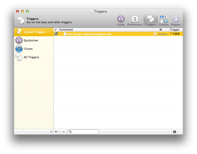

Install the Quicksilver program and put the sample applescript (easy.scpt) in your Documents directory.  Add the trigger and set the hotkey to Command-Alt-Control-W, as shown.  I've also included a script that's specific to Mail.app that will tell you if you have new mail.
