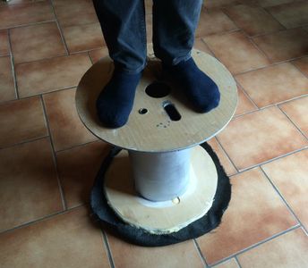

Step 3: Fix the Fabric
For this one you might need a friend:
Lay the fabric on the floor, center the foam on it and put the drum above upside down. You will now need to apply pressure on the the drum to compress the foam in order to get the fabric well taut once it's fixed. You can try to put heavy objects on it, but the simplest way to do so is to ask a friend to stand on it (Your friend doesn't have to be heavy).
You can now proceed stapling the fabric on the drum. Stretch the fabric as you staple it, the method to get it well taut is to staple alternately on the opposite side while you turn around the drum.
