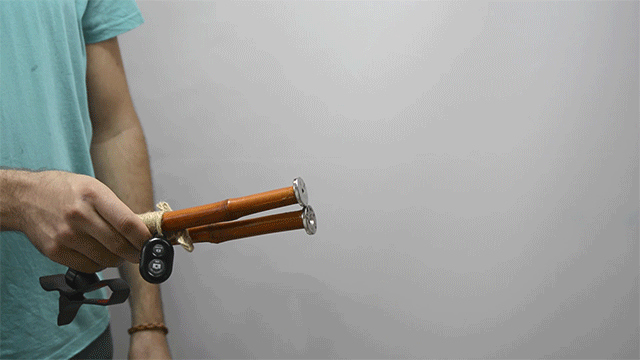

Step 1: Prepare the Bamboo
Cut a piece of bamboo as long as you want your selfie stick to be.
Then, cut that stick in half.
Step 2: Glue the Magnets
Glue strong, large neodymium magnets to one end of the each stick.
I used epoxy glue for the job.
Step 3: Make a Handle
Put some glue on the handle.
Wrap a string around it.
Step 4: Attach a Mobile Phone Holder to the Stick
Depending on the mobile phone holder you got
Cut off the head-ball and glue it to the stick.
Step 5: Attach the Remote
Tie a Bluetooth remote to the handle.
Step 6: Enjoy Your Selfie Stick
Selfie stick is small enough to put it in the bag.
Gravity and magnets will let you open the stick with one hand.
You can also attach the stick to almost any lamppost.
Great for those times when you want to take a photo without holding the stick.
