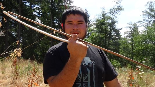

Step 3: Carving the Atlatl
Now it's time to start carving the atlatl. The first step is to find a suitable branch. You want something that is somewhere between 1/2 an inch to 1 and 1/2 inches in diameter. The smaller the branch, the less work required to get a nice high-performance atlatl. At the same time, you also risk the atlatl breaking especially if dropped or fallen on. The thicker the branch the more work required, but the result will be more durable and give you more options for tuning and finishing later on.
With your hand axe or similar large cutting tool, chop a branch near an offshoot. The offshoot will either be used as a spur, or become the reinforced base of an integral carved spur. I'm using maple, but almost any wood will work for this. Green wood is easier to work with stone tools than dried or seasoned wood.
Once the branch is cut off the tree, measure along your arm to get the atlatl's length. It should be around the length of your arm from armpit to wrist. Cut the branch to length and use your finer cutting edges to clean up the spur area. Once that's done, you can scrape off all the bark to allow the branch to dry faster. This will also result in a nicer finished product. Sometimes having a tool that makes you feel good is as important as having something simply utilitarian in a survival situation.
*Note: I ended up breaking the first atlatl by trying to throw very heavy darts with it. The last picture shows the replacement I made. The first atlatl was made of a 1/2" branch, the second out of a 3/4" branch. It took about twice the time to work down with the hand axe, but all the steps are the same. In a survival situation, it's sometimes better to cut losses and build a new tool rather than agonize over and try to repair a tool especially if you don't have the time or resources. Above all, stay positive.

Step 6: The Finished Atlatl and Dart!
Here's the finished atlatl and dart! Now it's time to hone your atlatl skills and do some target practice. As you throw with it, you can refine the shape and get it where you want it. Since everything is fresh and green, both the dart and atlatl will change as they dry. They will both get a little stiffer and tougher, so any major shaping with stone tools should be done now. As you throw, you may want to adjust the spur. here you can see I've actually carved an integral spur where the little offshoot was as it is a little more robust and I can put more power into my throws.
Wait until the atlatl is dry before trying to put a fine finish on it because fibers will rip out of green wood and leave a fuzzy finish. Once it dries, a fresh stone flake used as a scraper will clean the surface and leave it pretty nice. If you want a smoother finish, a sandstone or rougher stone like basalt or granite can be used like sandpaper. If you can't find that, sand or dirt with a little water on a smooth stone will also work for polishing. Finish the wood with some kind of oil once dry to prevent moisture getting in or the wood getting brittle.

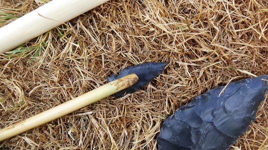

After finishing the atlatl and dart, I went ahead and refined them with some primitive tools. I let the atlatl dry for a day and then finished it off with an abrader stone (sandstone) and some fine obsidian flakes. I did the final polish with a bamboo leaf and some coconut oil. The dart was straightened over a stove.
I took the broken hand axe and knapped the pieces with an elk antler billet and deer antler pressure flaker. I ended up with a little chopper/hand knife and a nice atlatl/arrow point. This stuff is a little tougher than the dacite I'm used to, but at the same time it doesn't step as much. I hope to find more of it to make some nice arrowheads. Alongside the point and blade, I also got a nice pile of flakes for use as scrapers and for making small arrowheads/microblades.
