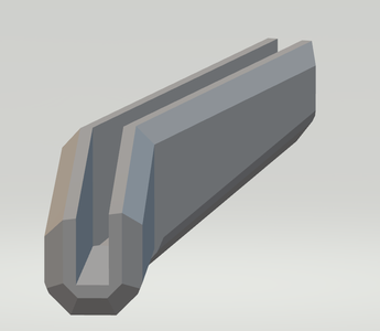

Step 2: Fire Up the Printer
Printing will probably take a couple days on a slower printer like mine, which is why I recommend starting this first. I used grey PLA, and painted some green PLA, but I'd do it all with gray filament if I had it. If not rattle can away. Each piece use your best judgement for infill/orientation/supports/etc. There's a lot that I would change, but all the pieces worked, so I just used them as is.
You'll need the following:
- 4x Bracket 7 (These hold the shape of the wings) (The side that is flat on the open edges goes on the angled section of the wing)
- 4x Bracket 8 (These are the mirror image of 7) (The side that is canted down on the open edge goes on the strait part of wing)
- 1x Bracket 14 (Attaches unit to bike) (Could be reworked as the angles weren't quite right, but it worked)
- 1x Bracket 15 (Other side of 14) (The bolt holes weren't big enough for tools to fit in, and the nut side could fit the nut to make life easier)
- 1x Bracket 16 (Attaches wings to dowel) (Could be reworked to remove the slot for the body since I didn't use it)
- 1x Bracket 17 (Other side of 16) (Could be reworked to have cambered edges like parts 27 and 28)
- 1x Bracket 18 (This is for the window)
- 1x Bracket 21 (This supports the cockpit, and attaches it to the bike - I would remove 2 holes, and make the laser holes smaller)
- 1x Bracket 22 (This is for the buttons) (Remove 2 holes to match 21)
- 2x Bracket 23 (These form the shape of the body)
- 2x Bracket 24 (These form the shape of the body) (no need for mounting holes - they weren't used)
- 1x Bracket 27 (optional) (I put these on in case I wanted to have it be wearable instead of attached to the bike)
- 1x Bracket 28 (optional) (Other side of 27)
